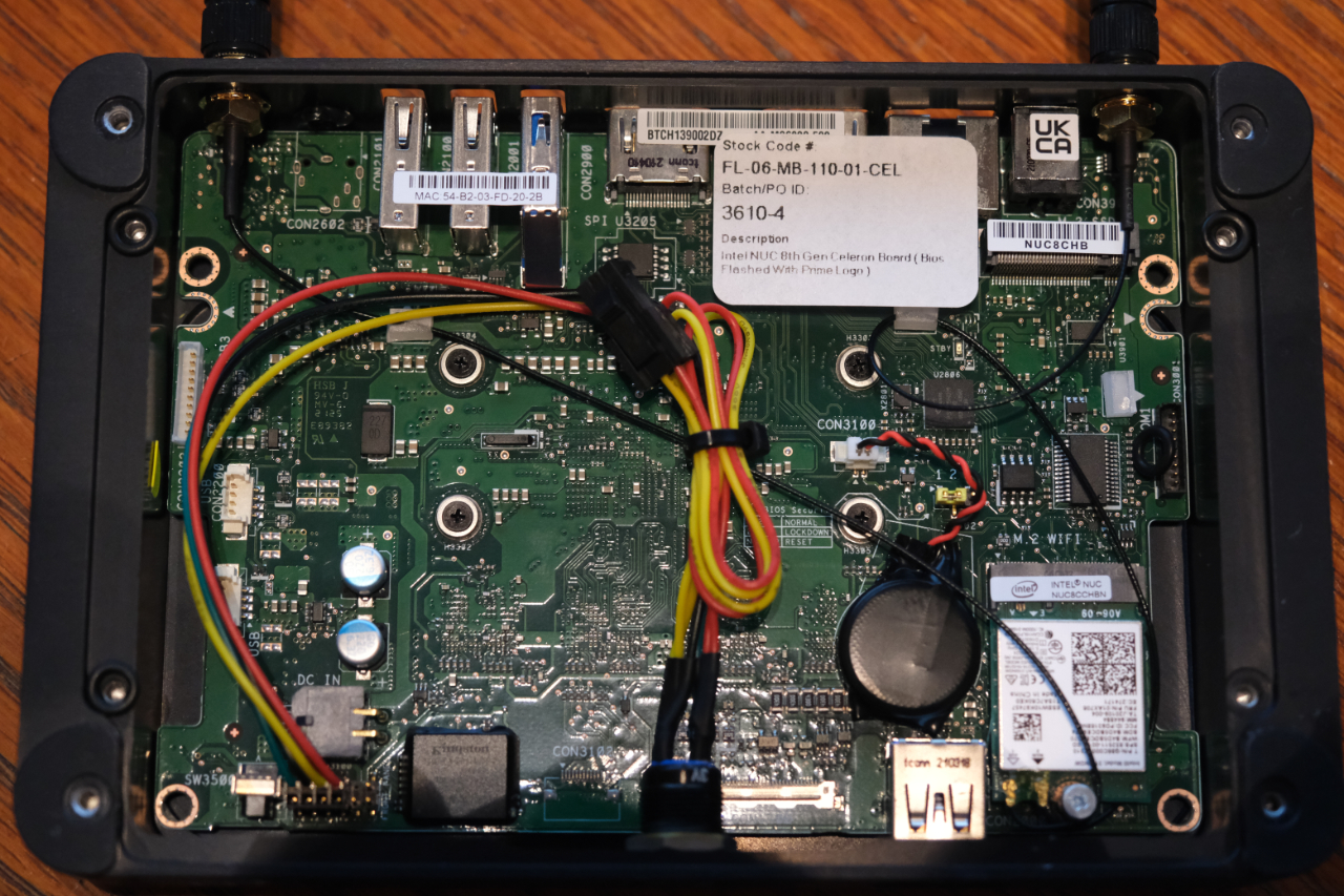

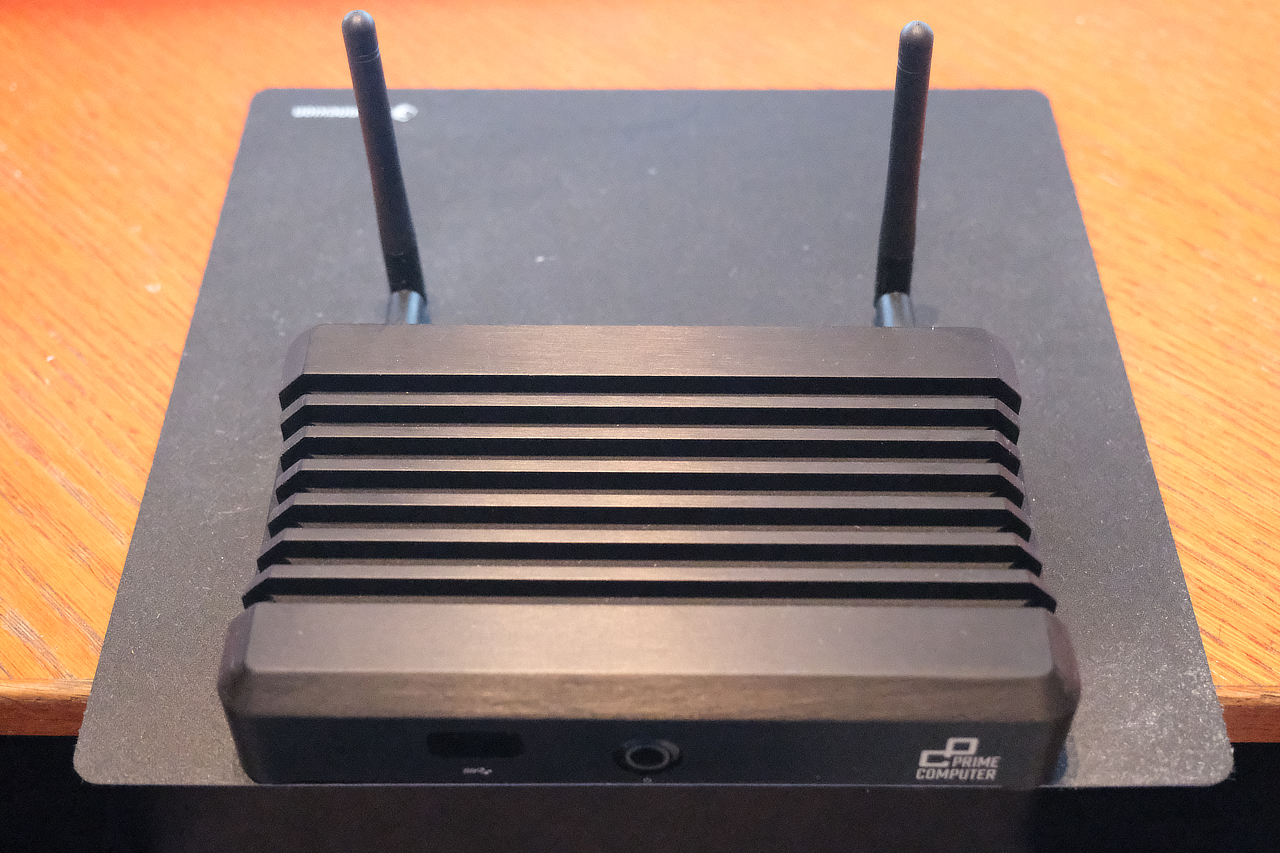

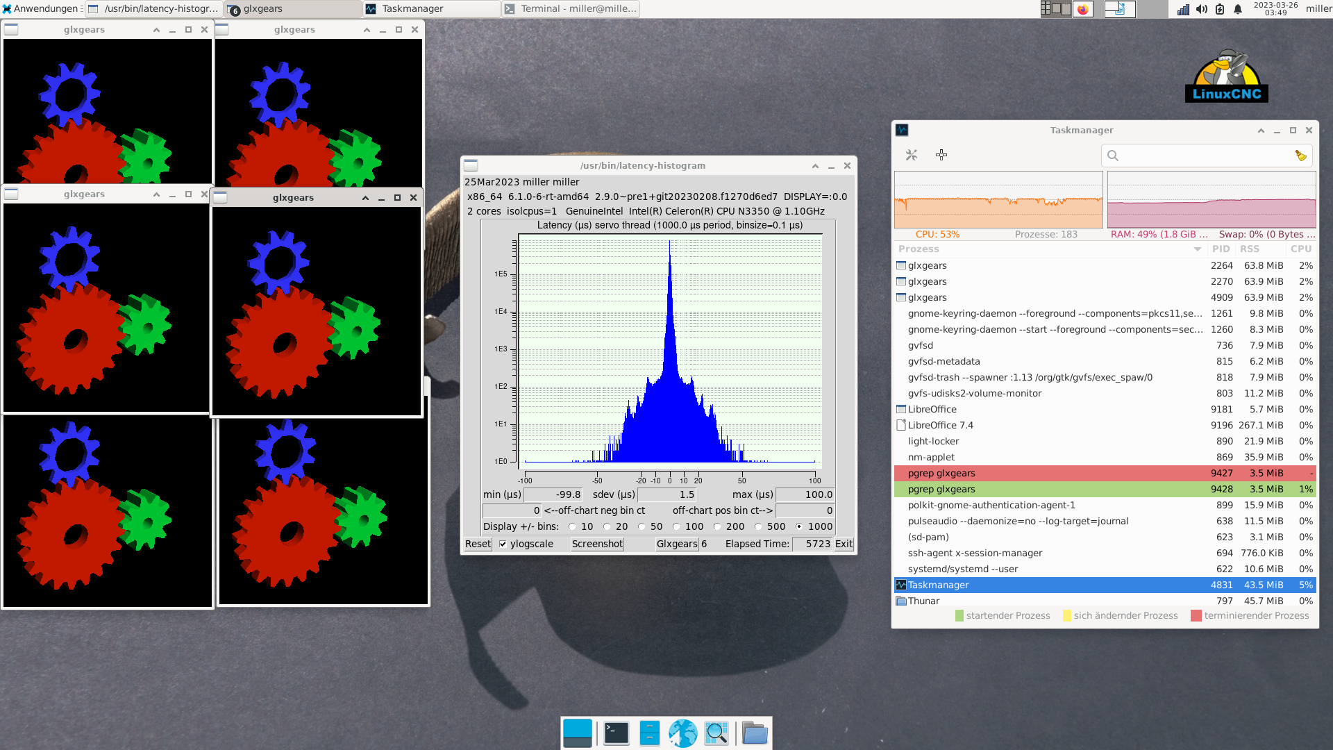

I got this fanless device, the board is NUC8CHB, Celeron N3350 .Before using as intended, i installed Bookworm and Linuxcnc 2.9. Installation was running perfect, including glade.Here is the latency test, 6 glxgears, Office document, geany, youtube video running. Operation is getting a bit laggy. Without Youtube, everything is fine and then the min / max values are from -45 to 45 My config is not ready for python 3, so it will take a while to test on the real machine, but definitely will have a try.
