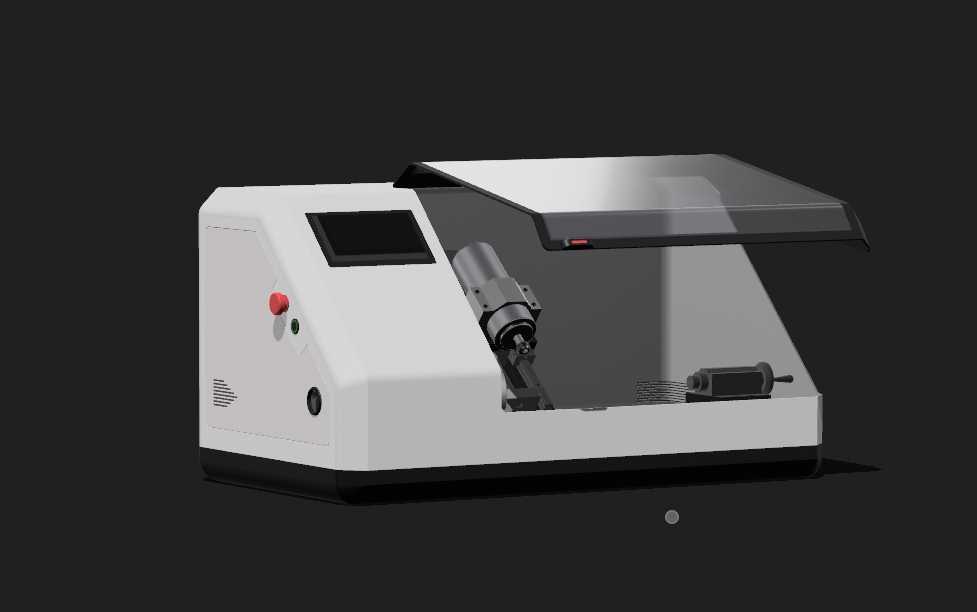

Hello everyone, let me introduce my LinuxCNC project (ARMCNC). The RDK X3 development board is my primary development platform, and I've been using it for various projects. Recently, in my spare time, I've undertaken the LinuxCNC adaptation, starting from building the Debian 12 system to installing and deploying LinuxCNC. Next, I will officially launch the open-source ARMCNC project. I hope that friends who are interested can join in. I am proficient in various technologies beyond ARM embedded systems.
Here is the information about the development board I am using:
I will keep all the documentation updated and open-source:https://github.com/armcnc
My idea for this project is quite simple because I have a passion for these things. However, I am only proficient in technologies like Vue and Go, and I have limited knowledge in hardware. Therefore, I hope that through this project, we can make the use of LinuxCNC simpler.

you are using the development board as the hardware driver as well?

Currently, it is only used for the operation and debugging of LinuxCNC. The adaptation and debugging of EtherCAT have been completed. Next, we are researching and adapting GPIO control. Once this is done, a combined system operation and motion control development board will be designed.

There is a new GPIOD driver that may help
linuxcnc.org/docs/2.9/html/drivers/hal_gpio.html
