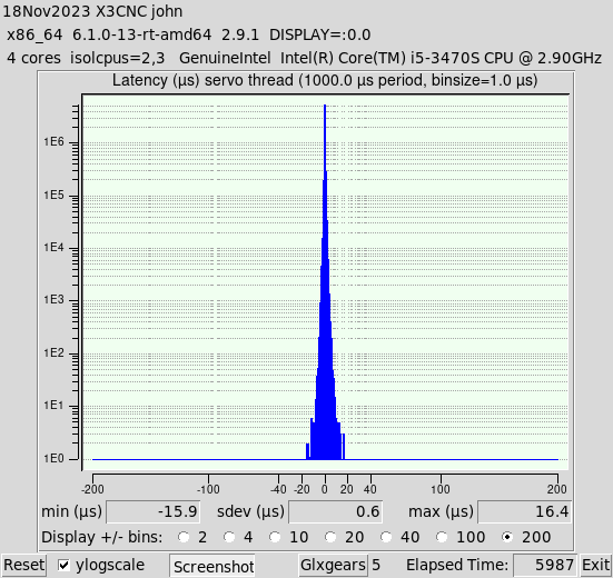

- JohnnyCNC
- Posts: 572
- Thank you received: 115
19 Nov 2023 08:17 #285898
by JohnnyCNC
Replied by JohnnyCNC on topic IRQ affinity on PC Debian Bookworm
- Posts: 22030
- Thank you received: 7504
19 Nov 2023 11:32 #285922
Replied by tommylight on topic IRQ affinity on PC Debian Bookworm
Probably not.
Try using USB2.0 or the black colored ones, not the blue ones.
A lot of cheap USB2.0 devices will have issues with USB3.0 and 3.1 ports, some USB3.0 sticks will switch back to 2.0 as soon as you start to copy something to/from.

- JohnnyCNC
- Posts: 572
20 Nov 2023 18:25 #286121
by JohnnyCNC
All of the USB ports on this machine are black. I tried moving devices around and it seems to be better but not completely OK. I have a wireless keyboard/mouse dongle, Touch-screen connection, Vista P4-SE pendant, and a USB to Ethernet adapter. This PC had been sitting for a couple of years so I am going to exercise all of the connectors really well just in case they are dirty.
