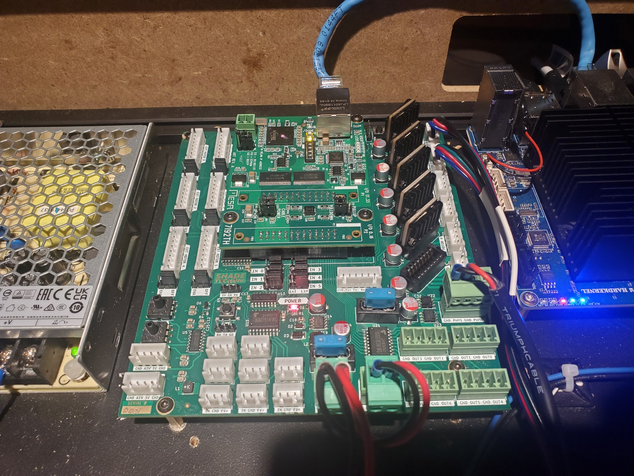

I should clarify what interface I am currently using with the rp4b, and the reason I mentioned rpspi.ko as the driver.
It is an inexpensive mesa 7i90HD which has a huge achilles heel in that it has no buffering between the fpga and the outputs which are also on hard to use 50pin dual row sockets identical to the old cables used with scsi-2 drives.
Mesa also has/had a 7i42TA card which you can stair case mount on top of the 7i90HD which brings the 50 pinners out to a more std 2 row screw header similar to the connectors used on our popular drivers, and which make hooking it all up a piece of cake, and it does a great job of gobbling up the noise that can kill an fpga in microseconds, but it also brings the price for all of this to around $200 USD.
Its an extremely capable interface, giving 72 total pins I'm only using around half of.
Room for tool changers, tool post grinders, smart tailstock controls etc. If you can program it into hal, this interface combo can do it.
And more importantly my ethernet port is free to be used for std networking, I can browse this ball of rock and water with firefox and the only problem is firefox's hogging of IRQ's plays hell with the latency, so I don't run gcode while checking you-tube.
That also leaves its usb ports free, so I have two SSD's on them that allow me to run both a kernel build and a build of master from github, right on that rpi4b as I've a buildbot I wrote there.

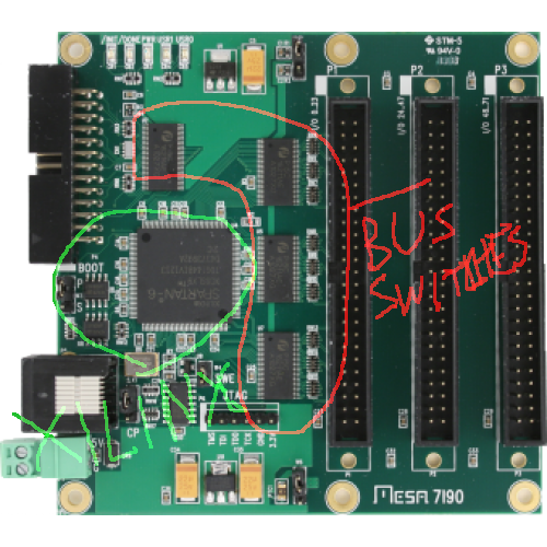

That's more or less the point. These types of cards also us bus switches between the FPGA and the pin headers. It's not the "Field IO" some of the cards have but it does decouple the FPGA from external devices.
Replied by blazini36 on topic about Mesa bus switches
That's not an "achilles heel" and it's actually not quite true. All of the 26/50 pin headers on Mesa cards are like "GPIO" on any other device, 5v tolerant and not "field ready". That's the point of the card, you add the field level IO and firmware as necessary rather than having a card that you're locked into. I use a 7i92 to make this:It is an inexpensive mesa 7i90HD which has a huge achilles heel in that it has no buffering between the fpga and the outputs which are also on hard to use 50pin dual row sockets identical to the old cables used with scsi-2 drives.

Ahh, but unless Peter has modified the 7i90HD, there is none of that on /that/ card, the 50 pinners are connected directtly to the FPGA, and can be easily destroyed by voltages even 1 vbe above the 3.3 volts from circuit noise or ringing, and from Peter, even less than a vbe below ground.
I destroyed three of them, and the 4th has one blown gpio before I bought and installed the 7i42TA's which protect the fpga. That's one of the reasons that card was so low priced at $65 USD when I was trying to prove I could run cnc on an rpi3b originally. Then I also redid the grounding into a single bolt star ground, which killed 98% of the noise.
I am a CET, and own Siglents priciest scope, a 4 channel sampler with a 350 MHZ front end, and its amazing what you can see and analyze with that in your hand. The ringing of a circuit edge going up can be seen with the ring above 3.3 volts being squared off, clipped at 3.4 volts by the action of that 7i42TA. Ditto the corresponding spike at the falling edge, clipped flat for several nanoseconds at about -.15 volts. The 7i42TA is doing its job.
Those buffers are on the 7i92, but not on the 7i90HD,

You're are getting confused. Page 2 of the 7i90HD manual:
All that talk about electronics gizmos and you can't see the bus switches on the card? Even in the pictures? I own a 3 $200 Chinese scopes and even I can see the bus switches.
I doubt Mesa has any card where the IO goes straight to the FPGA
You can see the bus switch ICs on the picture of the 7i90HD, there's like 4 of them, They are probably SN74CBT16211CDGGR, which is the same as on the 7i92. I've had to replace them already (my fault).To allow interfacing with 5V inputs, the 7I90HD has bus switches on all I/O
pins. The bus switches work by turning off when the input voltage exceeds a preset
threshold. The 5V I/O tolerance option is the default and should normally be left enabled

No, what counts is when you post things on forums that are a "matter of fact" you should at least try to be correct. I've been wrong many times but when it's obvious I'm wrong I admit it. The 7i90HD never got a Trion FPGA revision so there's probably only ever been 1 major revision and judging by the picture it has the same exact bus switch layout every Mesa card with a pin header or DB25 has:
