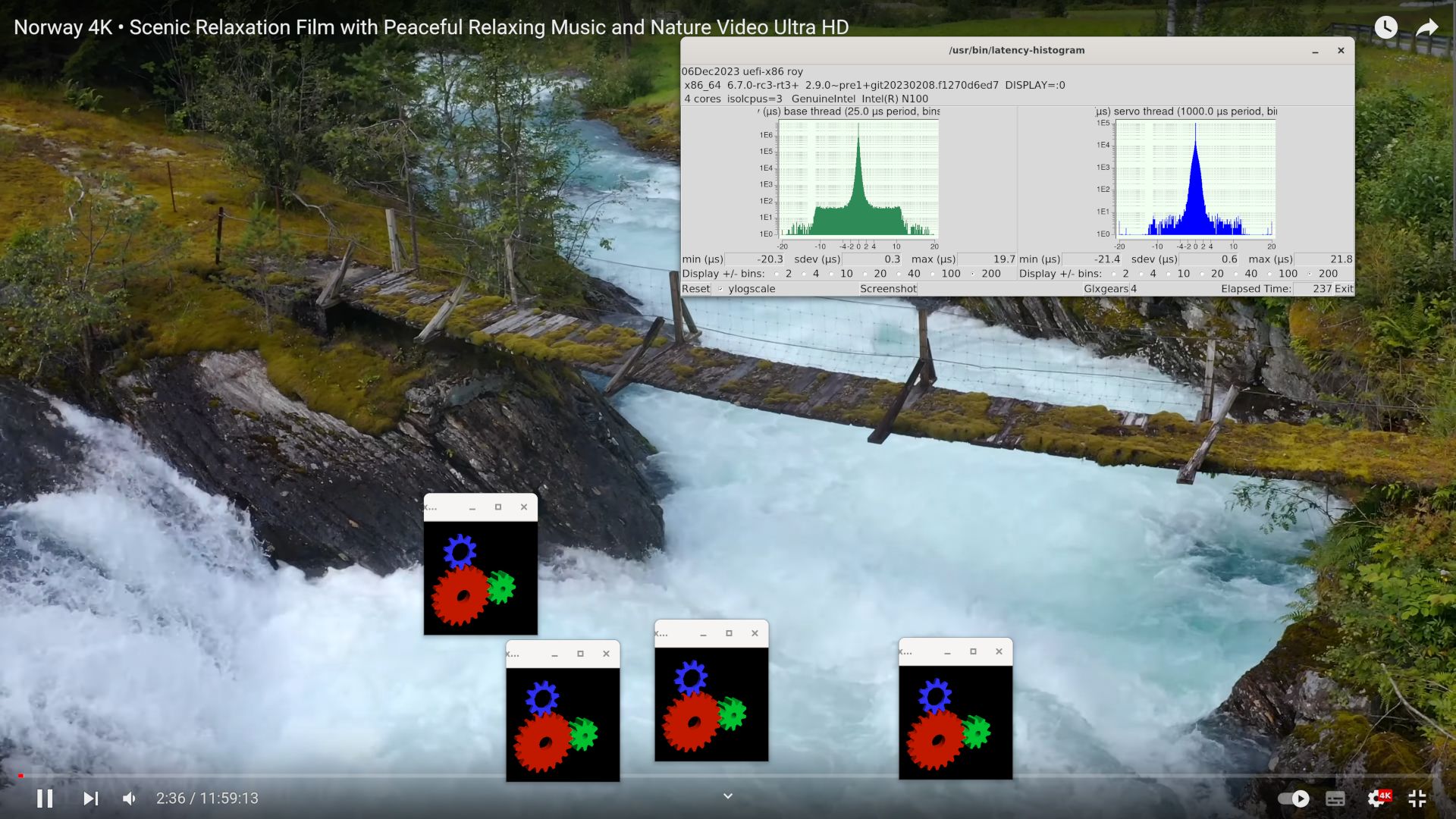

I've got one, did a quick test a few months ago but did not get good results at that time. When I see time I'll test more. There are many BIOS options like different values for the turbo but didn't see the options I was looking for.
Perhaps it will perform better with the current kernel since it's a relatively new board.

With the newer kernel/patch it works already much better, a few outliers but the only thing I've tried so far is isolcpus=3

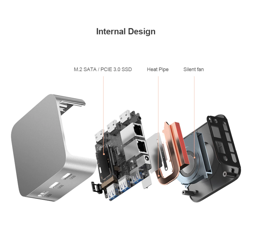

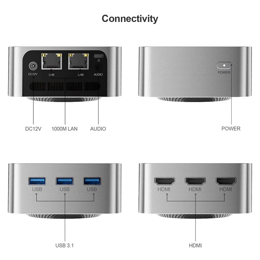

Intel N100 works great with Debian 13 (Trixie pre-release) and LinuxCNC 2.9.3-1+b2
I have achieved good results with a cheap and super small N100 mini PC, with 16GB of DDR5 memory, a 256GB NVMe drive, dual LAN and Wifi/BT. It is available on AliExpress and other channels as a T8 Plus and it is sold under different brand names. The price varies between 120.- and 200.- USD depending on the configuration. I attached some images below.
It came with Windows 11 Pro pre-installed and activated. I decided to go for a dual boot system, keeping Windows and installing Debian in a separate partition, so I could use Windows for my servo motor tuning software.
In order to try something new, which is usually more fun, I decided to install Debian Trixie (yes, pre-release Debian 13), via the text based installer, which went flawlessly. I chose Cinnamon for the GUI, which often gave me somewhat unstable lacencies under Debian 12, probably due to some graphics driver issues, and I was curious if Cinnamon would perform better under Trixie. After booting my new Debian 13 system, I opened Synaptic and installed linux-image-6.10.9-rt-amd64. Then I rebooted and confirmed that Debian was running with the RT kernel:
which showed: Linux <pc-name> 6.10.9-rt-amd64 #1 SMP PREEMPT_RT Debian 6.10.9-1 (2024-09-08) x86_64 GNU/Linux
Next I installed LinuxCNC version 2.9.3-1+b2 from the Trixie repository, including the optional dev package, via:
Nice to see that the latest stable release is automatically installed from the Debian Trixie repository
I did some latency tests without any BIOS changes or using isolcpus, and as to be expected the results were quite terrible with values for both the servo threat Max Jitter and base thread Max Jitter above 600000ns. (yes, six hundred thousand; it is not a typo). During the latency test I had 8 instances of glxgears running, internet connection via the build-in Wifi, Firefox had two tabs open with YouTube videos running and I was browsing the internet.
I then went into the BIOS settings and ONLY disabled Virtualization. After rebooting and doing another latency test, the results were much better, but still quite high. Before making any additional BIOS changes I decided to first play around with isolcpus to figure out which core(s) should be isolated from the general scheduler in order to get the best performance. I tested all possible combinations under the same test scenario as mentioned above, which took me several hours, and I found that isolcpus=1,2,3 resulted in the most optimal latency values. The Max Jitter values for both threads stayed below 20000ns, which is totally acceptable.
Next step was going back into the BIOS in order to disable things like C State and other power saving features, which is usually recommended to reduce latency, but strange enough disabling those only resulted in HIGHER latency instead of lower, so I stayed with only disabling virtualization and left the rest in their default settings. While I am typing this, the computer has been running for a few hours with the latency test and all those background programs running, and the Servo thread Max Jitter is 17646ns and the Base thread Max Jitter is 18711ns. Perhaps in the next few days I will take another look at the BIOS settings, trying to further reduce the latency, although I realize that is really not needed. All in all I am more than happy with this N100 mini PC. I will also test with some different desktop environments, especially lightweight environments like XFCE and LXQt. I may follow-up with another post about my findings.
As a PS: for those who want to use a Qt based GUI, like QtDragon, a Python file needs to be modified. Debian 13 comes with Python 3.12.6 installed. As from Python 3.12 locale.format is deprecated and needs to be replaced with locale.format_string in three places (lines 270, 277, 281) in the following file:
This fix is already implemented in the upcoming LinuxCNC 2.10 release, available on the LinuxCNC github page as a work in progress.
I hope this may be helpful for those looking for a modern cheap PC for LinuxCNC. N100 is definitely a suitable solution.
