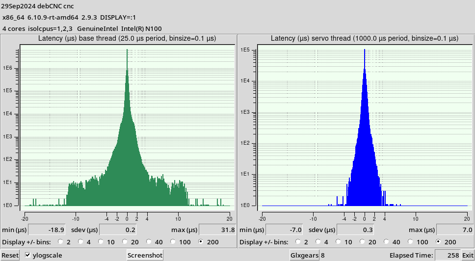

I believe I have the same N100 mini PC. Here are the results of my stress testing, running for a couple of hours with 8 glxgears, two YouTube videos constantly playing, working with FreeCAD for my new machine design, and doing some compiling in the background.
I running on Debian 13 (Trixie, weekly build; so far absolutely stable despite being not released yet), running KDE and LinuxCNC 2.9.3-1+b2

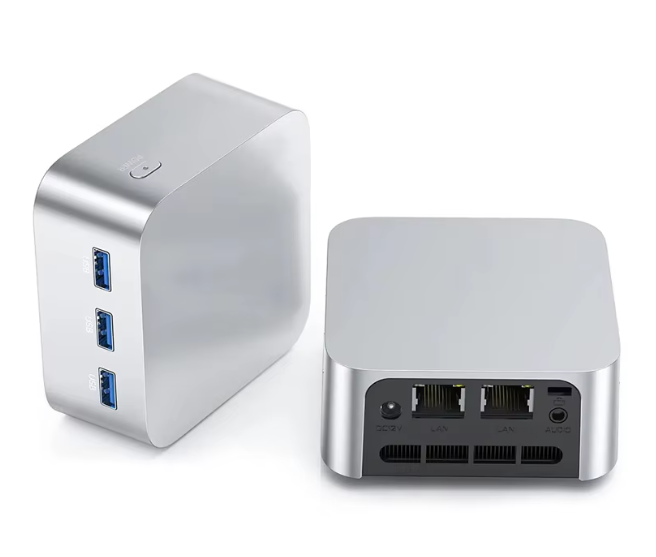

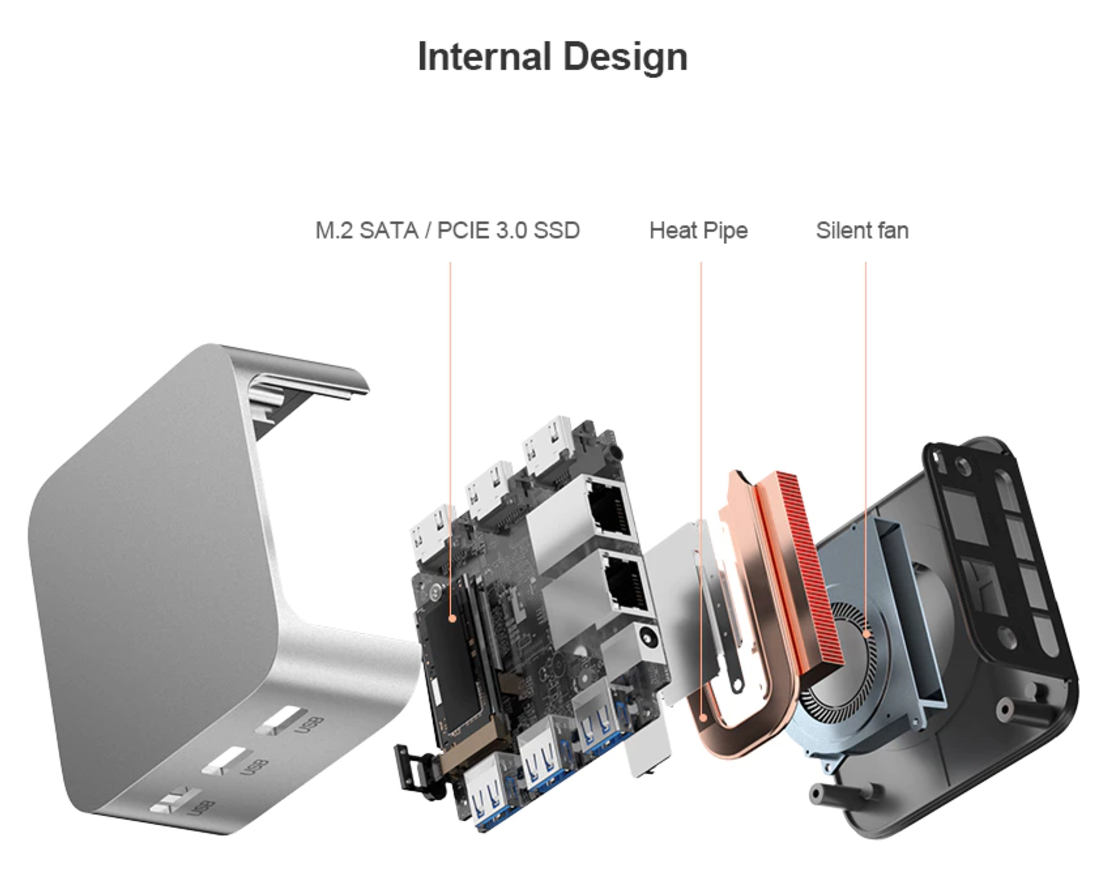

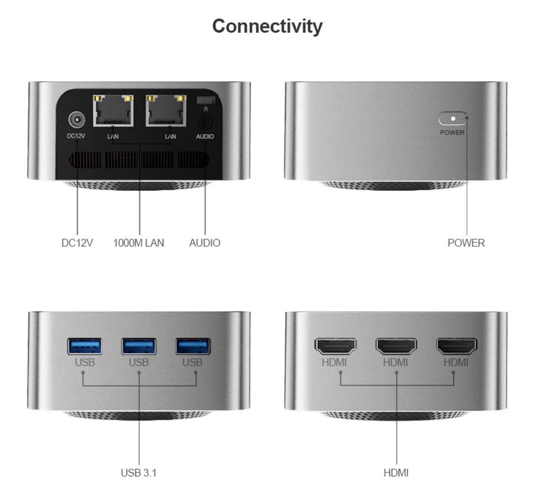

Hi Wrightys99, if you want the same mini-PC that I have, go to Aliexpress and seach for "T8 N100". The result will show many of these mini PCs, sold under different brand names, like Chatree, Firebat, or no name at all. Mine has no name. As far as I can tell they are all the same. Just pick the cheapest with your preferred configuration. I bought mine for around €150,- with 16GB RAM and a 256GB SSD. Make sure it has the N100 processor, not the older N5095. Although I ordered it without an OS, it came with Windows 11 pre-installed and activated at no extra cost. So I just made the system dual-boot where I can use Windows for tuning my servo drives, as many servo drives come with Windows tuning software.
Below are some pics.

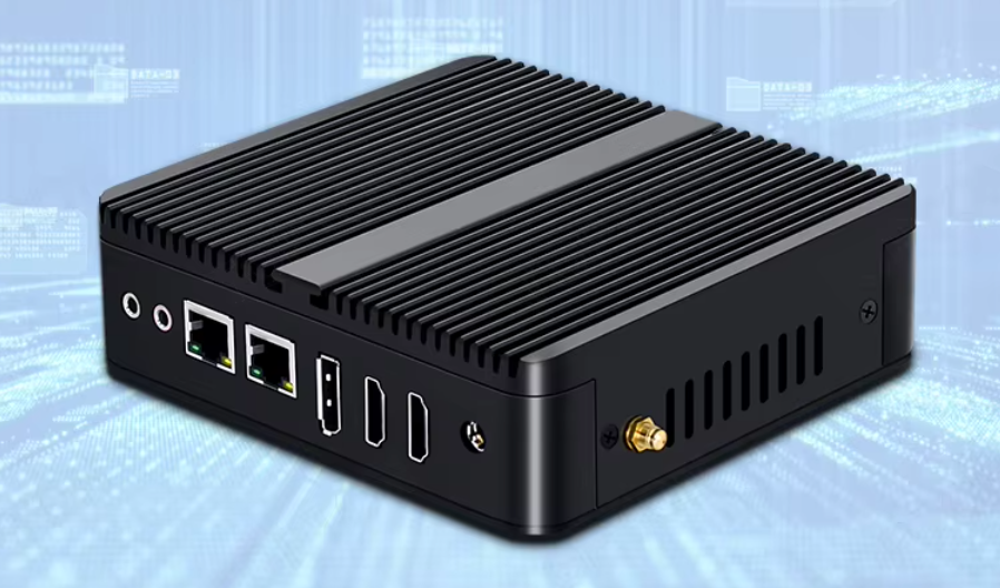

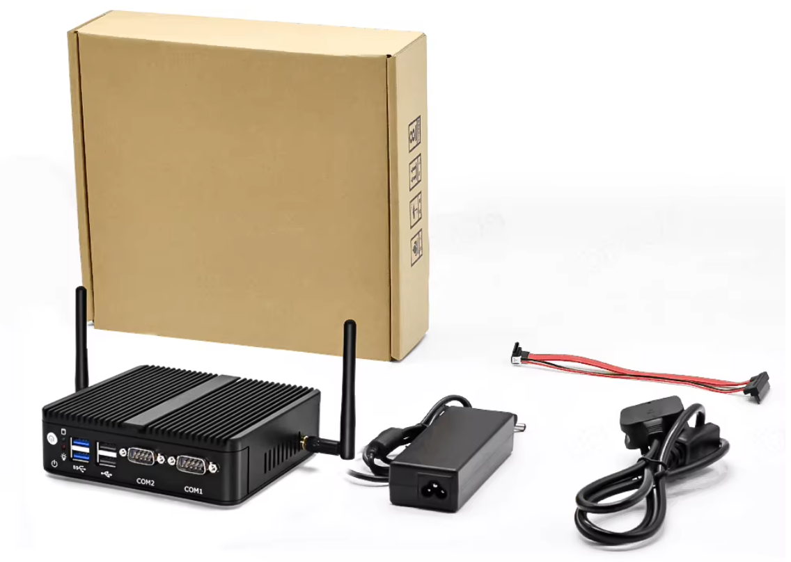

Hardware
  • PC: Topton 12th Gen Fanless Mini Computer Alder Lake N100 Quad Core Dual LAN 2 Industrial PC
  • Vendor: Topton Direct Store on AliExpress
  • Specs: 8GB DDR4, 128GB NVMe, WiFi, BT
  • Price: $142.60 total after some Black Friday discounts
  • Reason:
    • Old PC gave out due to overheat from dust / woodchips
    • Wanted new and cheap PC compared to the old/used stuff I've been always using.
    • I wanted an out the box, dual NIC device so that I can remote into it from my network and also have it connected to the Mesa Card. I knew about this chipset due to it being popular in the homelab space for those that run their own router (pfSense, OPNsense) since most devices that use this chipset have multiple NICs. Seeing this thread pop up in the search and the low latency results made it an easy choice for me.
    • Fanless, hopefully this prevents overheat in future as it'll be easier for me to clean. Having it now in an easily accessible area due to its small form factor will also help with that.

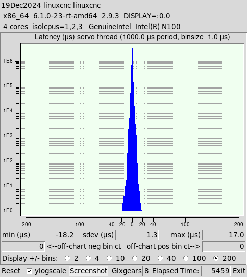

Latency test command
latency-histogram --nobase --sbinsize 1000 --show
Results
Lowest Latency Settings - 17.0 microseconds (μs) max
  • Test was run on an actual install of LinuxCNC 2.9.3 ISO image (not Live CD)
  • The following BIOS settings were Disabled
    • C-States
    • Virtualization
    • *Speed Shift
    • Speed Step
    • Race to Halt
  • isolcpus=1,2,3
  • *Stress tested single core by running
    yes > /dev/null
  • glxgears x 8
Notes
  • *Disabling Speed Shift gave me the best results by far, but made PC basically unusable for multi-tasking. I was going to have multiple YouTube videos playing, but trying to load it was unbearable so I decided just to stress test the CPU using the command line. With Speed Shift enabled made the PC great for multi-tasking but my latency increased to a steady 50 μs running glxgears x 8 and 2 Youtube videos. I don't intend on using this PC for anything else besides LinuxCNC, but it is cool to know I can multi-task on it while it is running as 50 μs suitable with a Mesa card.
  • Live CD proportionally gets worse results by about ~15 μs. The same test above got me 30 μs.
  • I was not able to install LinuxCNC 2.8.4 image due to a lot of driver issues. I was hoping to do a brainless PC swap, but I guess this gave me reason to upgrade.
Overall this is a cool little device, see attachments for pics. My biggest worry is buying a PC from an unknown OEM and future BIOS support. I guess we'll see if this stands the test of time. Otherwise, I am going back to my old, go-to, decommissioned Enterprise PCs.

Did you try isolcpus=3
isolcpus 1,2,3 leaves only one CPU for non-realtime tasks so
would likely be painfully slow...
