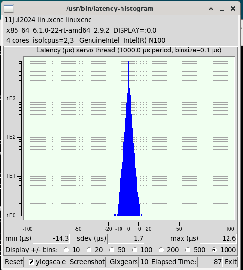

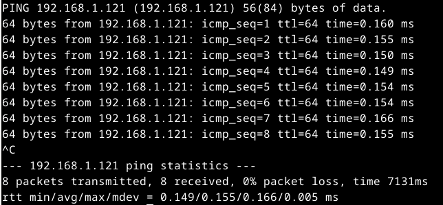

Hello all !
I've got an update to share now that the n100 seems to be operating properly. YAY!!!!
In the end I never could get the pings below ~1.5ms whilst using the previous ISO install, so inspired by the recent 2.9.3 release I tried again from scratch. This is what I did...
1. Download the 2.9.3 ISO from linuxcnc
2. Burn to USB, install to the N100 miniPC
3. Follow all the steps in the excellent @rodw guide : docs.google.com/document/d/1jeV_4VKzVmOI...I_PhCm1x7oiw8VcLFdiY
4. Once networking was configured I ping'd the mesa, and it reported <0.5ms replies. Awesome!
5. However, latency was still an issue. So followed the r8168-dkim install steps, and then critically the kernel options noted by rodw at step. 56, including the r8168.eee_enable=0 setting.
6. After that, latency super ! (images attached, with web browsing and file access going on).
I didn't run _rt_setup, but did add the isolcpus=2,3 to the kernel options.
About the only thing I didn't do from the guide, was that I didn't run _rt_setup. As things seem fine without _rt_setup I didn't want to tempt fate! Perhaps the issues previously helped by the _rt_setup irq pinning have been improved by the newer linuxcnc version or some-such.
So the moral of the story... If you are struggling with N100 or Realtek drivers, don't give up!
Try again with the latest linuxcnc and hopefully you'll find yourself with a fantastic MiniPC for CNC!
Thank you again for all the advice from everyone. It all helped form the final solution.
