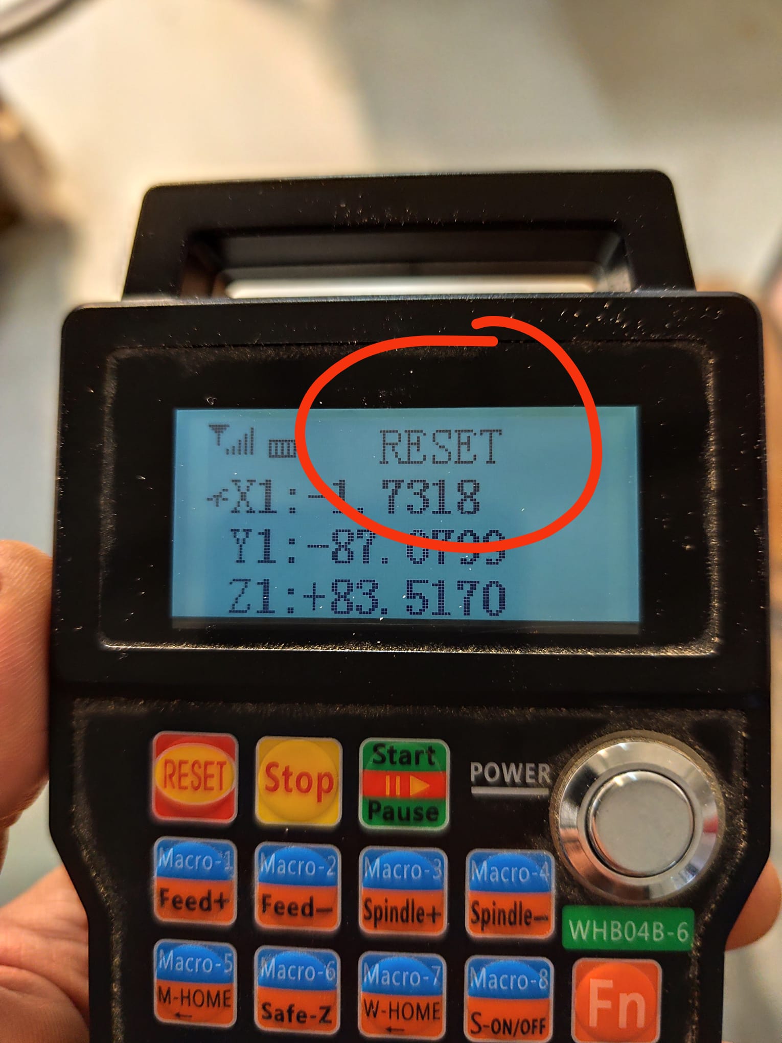

Hi, my MPG steering wheel stopped working, like that from one day to the next, suddenly. The rest of the buttons that I use work well, so I rule out that it is communication, it is just the pulse generator to move the axes.
It has not suffered any damage, I have put new batteries in it and I have restarted the machine several times to rule it out.
Does anyone have an idea of what could have happened, what could be the cause or what can I do to find out the fault or is it simply that the wheel has broken?
The model is WHB06B, I attached a configuration file that I had operational in case it is of any use.

03 Jun 2024 06:31 #302227
by RoberCNC
Replied by RoberCNC on topic MPG wheel not responding
I have observed that now the word "RESET" appears persistently on the LCD where "CON:60%" should appear (current running mode according to the manual).

04 Jun 2024 07:56 #302298
by RoberCNC
Does anyone have an idea how to reset the device? I have solved the voltage drop but "RESET" continues to appear on the display.
