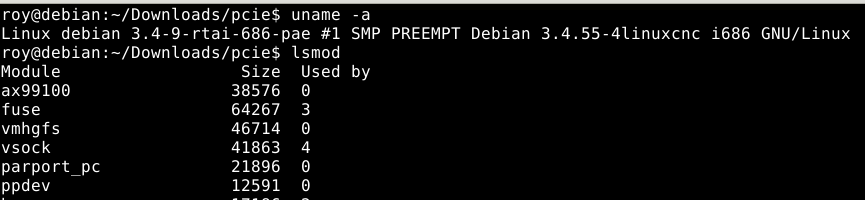

So when you remove the if... it always gets defined, or replace with:
#if defined(__x86_64__) || defined(__amd64__) || defined(__i686__)
When I replace these lines in ax99100_sp.c and parport_pc.c, I'm able to insert the module with "sudo insmod ax99100.ko"
drive.google.com/file/d/1bPI5vTtZvWeqOGH...HAT/view?usp=sharing
drive.google.com/file/d/15o3Yc9AOe5HOQ-a...A1Q/view?usp=sharing
So to install:
sudo cp parport_pc.ko /lib/modules/3.4-9-rtai-686-pae/kernel/drivers/parport/parport_pc.ko
sudo cp ax99100.ko /lib/modules/3.4-9-rtai-686-pae/
sudo depmod -a
Then take the first address of the parallel controller from the following command
lspci -v
For example: I/O port at d010
Then execute the following command with the correct address:
echo "options parport_pc io=0xd010" | sudo tee /etc/modprobe.d/parport_pc.conf
sudo reboot

24 Jun 2024 18:37 #303710
Replied by Cant do this anymore bye all on topic another pci-e to parallel port issue with "make" command
To tell the truth you really don’t need the parport driver to be loaded.
Linuxcnc will load without it. Like I said it my Parallel Port Treatsie thread, the only call to the kernel module is to get exclusive use of the port. If the call fails and your Hal file has the correct address it will still run.
As for the serial port driver, what’s the point in building it if the card doesn’t have the components for the serial port populated ?
If the card has been manufactured without the serial port headers and driver chip there’s a better than ever chance that the chip has only been strapped for Parallel Port operation and if that’s the case the card will only report the PCI id for the Parallel card, the chip reports the id depending on how it’s config pins are strapped. So if the card doesn’t report to the PCI id that matches those defined in the serial port module, the kernel won’t load that module.
I’ve had a read of the data sheet for that family of chips and it’s quite interesting what can be done with it.
Just out of interest if you want to know what Vendor & Product ID a kernel module supports you can run modinfo with name of the driver.
The problem with users coming from windows to Linux when installing new hardware that comes with a “driver disc” is that they assume that they need to build and install the driver. It’s rare that needs to be the case.
You can even google the vendor and product id of a device and you’ll find pages that will let you know if & when a driver that matches was introduced into the kernel.
Ages ago I attempted to get a thread going with the IDs of Parallel Port cards that were known to work. But after some initial interest it went silent.
There’s also a parport_serial driver (the name I may have muddled up) in the kernel that supports a lot of these cards that have a chipset that can present as both a serial & Parallel Port.
