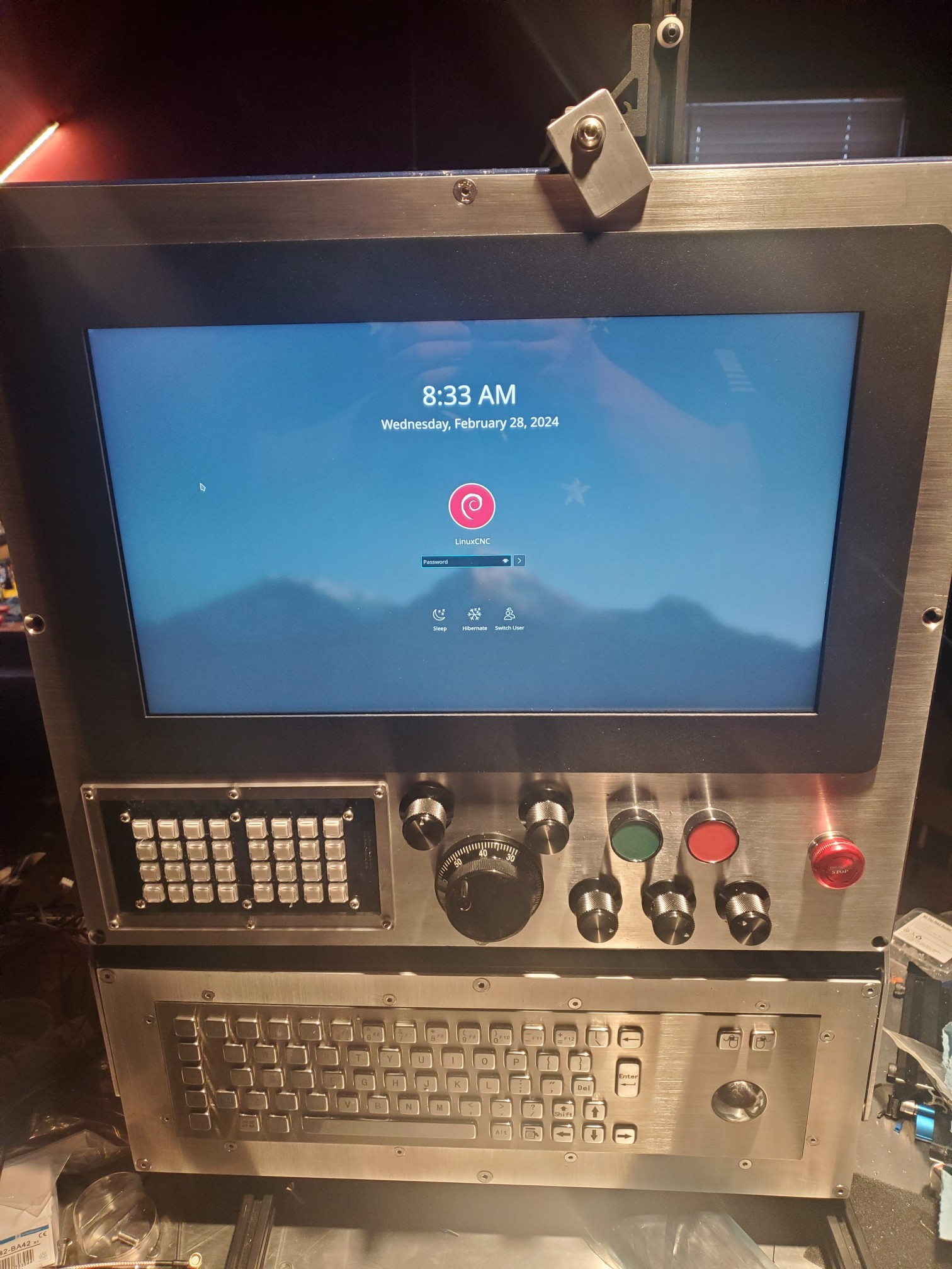

14 Jul 2024 21:37 - 14 Jul 2024 21:39 #305174 by blazini36
Replied by blazini36 on topic Touch Monitor Size - Any Consensus?
rodw post=304984 userid=20660the new GUI's you are considering are more touch friendly than Gmocappy which has a lot of tabs you need to open all the time . eg jogging.
QT dragon has a lot flatter UI but still has plenty of tabs but the jogging controls are always exposed.
Not quite sure I follow that one, Gmoccapy only hides the jog controls while you are doing something you have no reason to be jogging while doing. It's a pretty smart use of screen space. I've used it for years and never thought "I wish I could touch the jog controls while doing xyz"
How big the touchscreen is depends on how much of the controls you actually want on the screen vs real buttons. Touchscreens are almost a necessity IMO but they really get overused, there are plenty of things that are not great to do on a touchscreen. I haven't used QtDragon or Probe Basic but I think a monitor above 17" or 19" is silly. I've used Gmoccapy with a 19" touchscreen pretty much exclusively with a mill and I was never really in love with touchscreen jogging, I've just been holding out on doing something different. Even with a touchscreen keyboard you still need to break out a real keyboard sometimes and while the on-screen keyboard is fine it's still annoying if you have to do something outside of LinuxCNC.
I'm actually downsizing my touchscreen to a 15.6" in favor of real buttons and a real keyboard.  I may actually try out flex ui if the plotter works as I'd rather not have all the extra touchscreen stuff. Still waiting for some things to fall into place, but this is what I'm going to from just a 19" touchscreen:

15 Jul 2024 15:32 #305244 by GeckoWorks
Replied by GeckoWorks on topic Touch Monitor Size - Any Consensus?
I love that console! It's the one with the swivel joint to set the angle of the keyboard posted about somewhere else here, right? If so, I already have the pics downloaded to a folder for inspiration. But... I have promised myself not to look at those pics for a long time, haha.
Reason being, this is my very first CNC not to mention my first Linux endeavor ever. And I am not strong in electronics nor programming, so I've decided to try to keep it as simple as I can for now so I don't take too much on and end up running away from it.
As such, I think touchscreen and yes, not even hard buttons, even though I know they will be nice to have. And since I wont have them (yet), I will be OK with a larger screen.
Then with time, when I have actually put some hours onto the control and know my way around it and the machine, I may very well make something like yours - as I said, I frikkin love it:)
