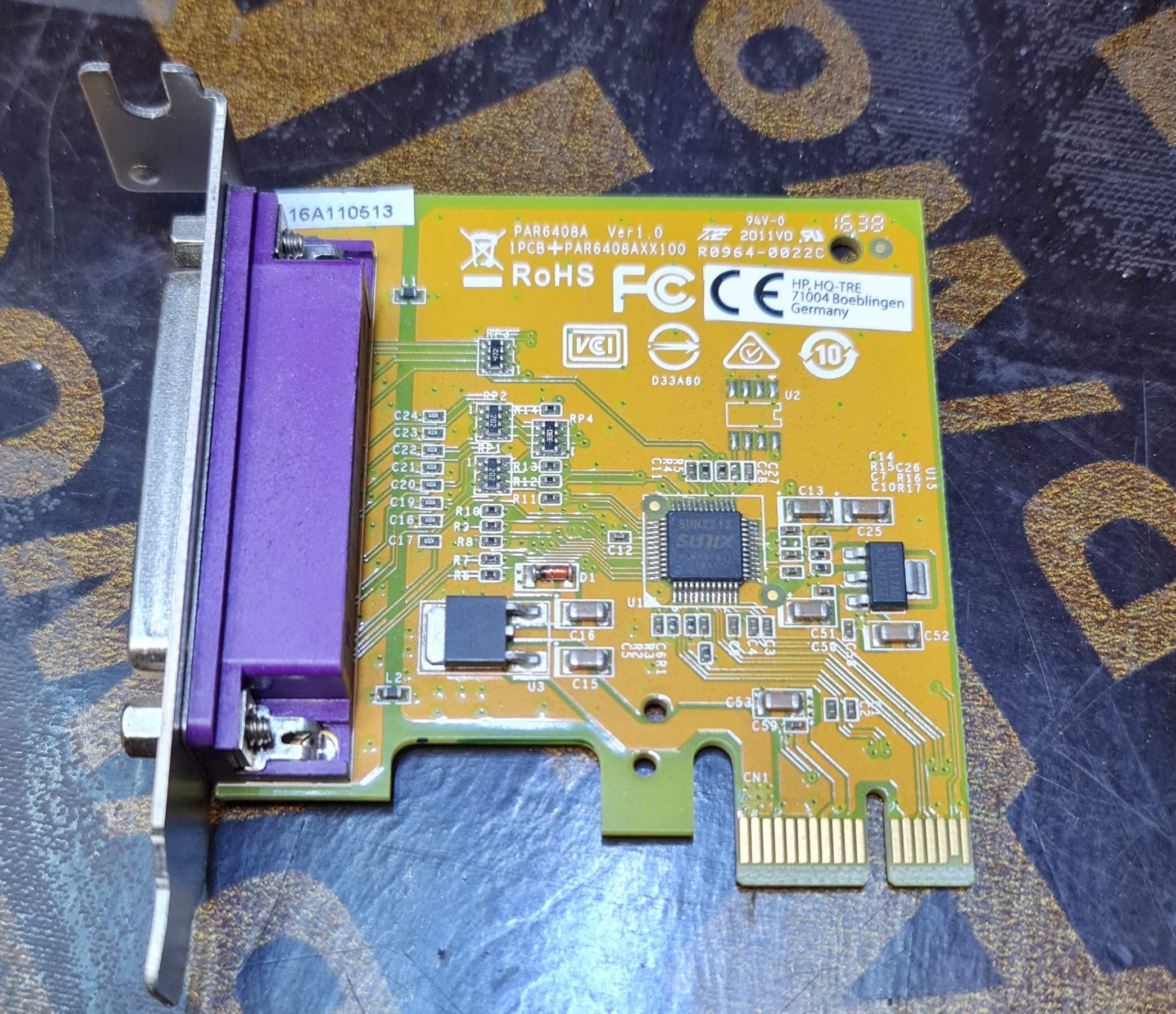

Replied by tommylight on topic PCI and PCI-E add on cards with parallel port that work out of the box

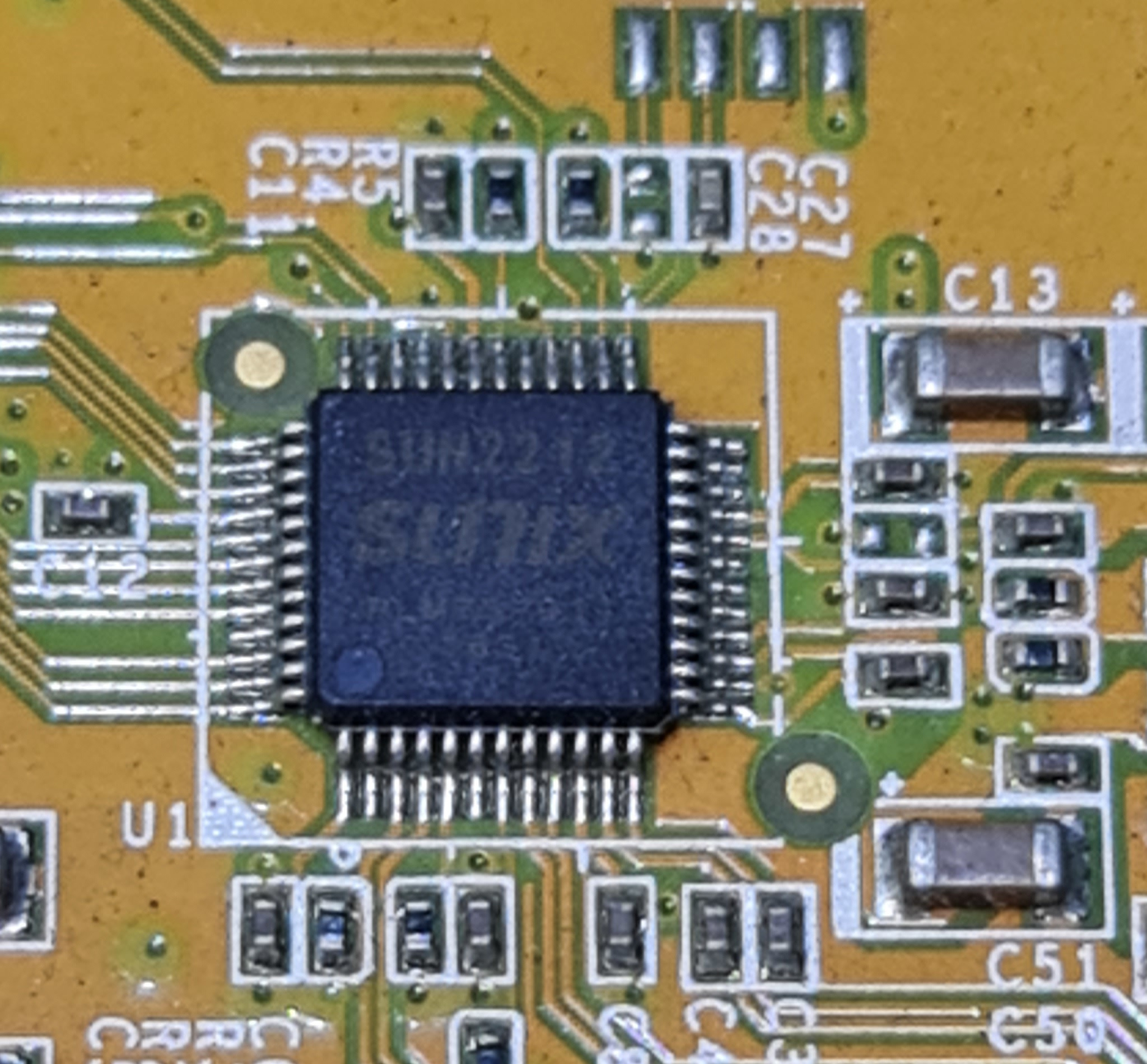

PCI-E to parallel, works out of the box, usually address is 0xd020, no complaints about "no parallel port found" from LinuxCNC 2.10.
Can be found only on HP desktop PC's, computer repair shops should have plenty, comes with the short bracket as pictured, price 10-15 Euro here.
Chip seems to be SUNIX SUN2212
It does support SPP, tristate and EPP

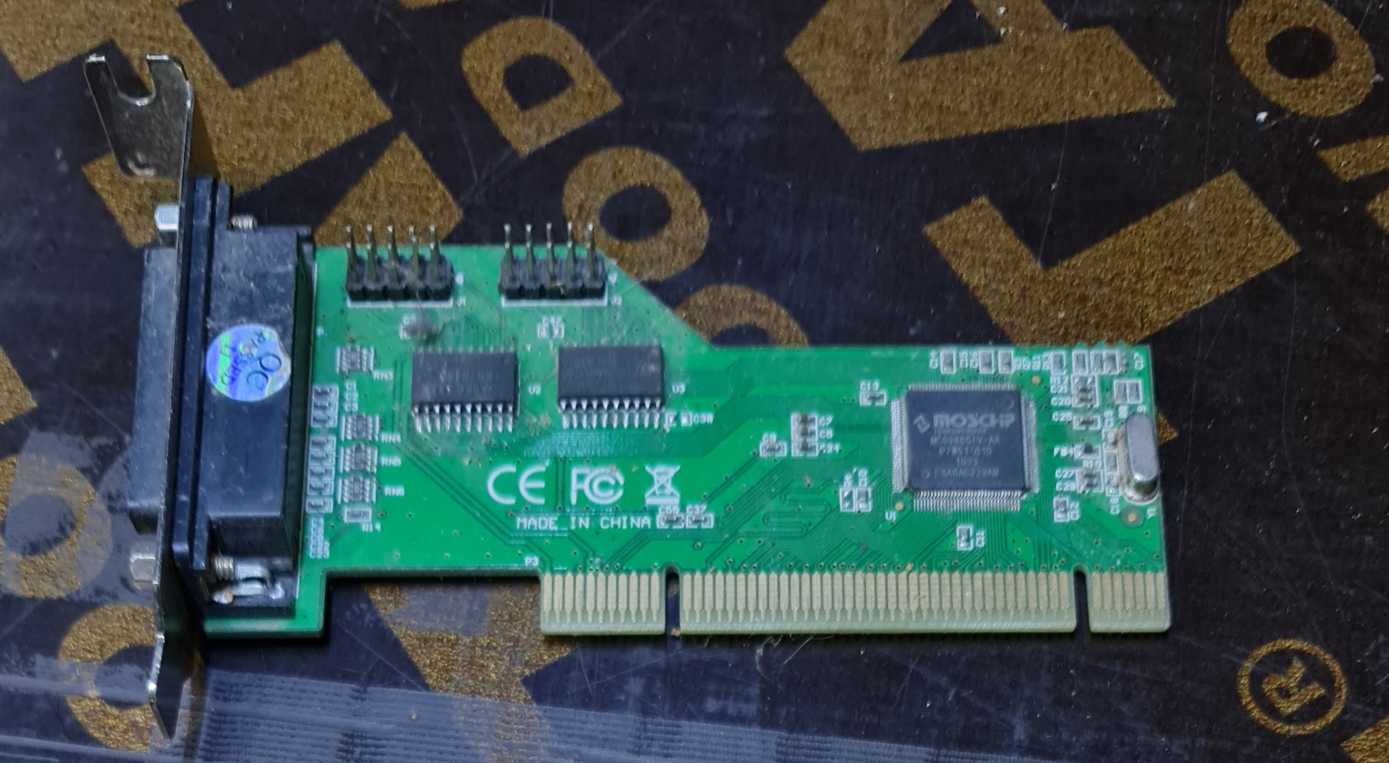

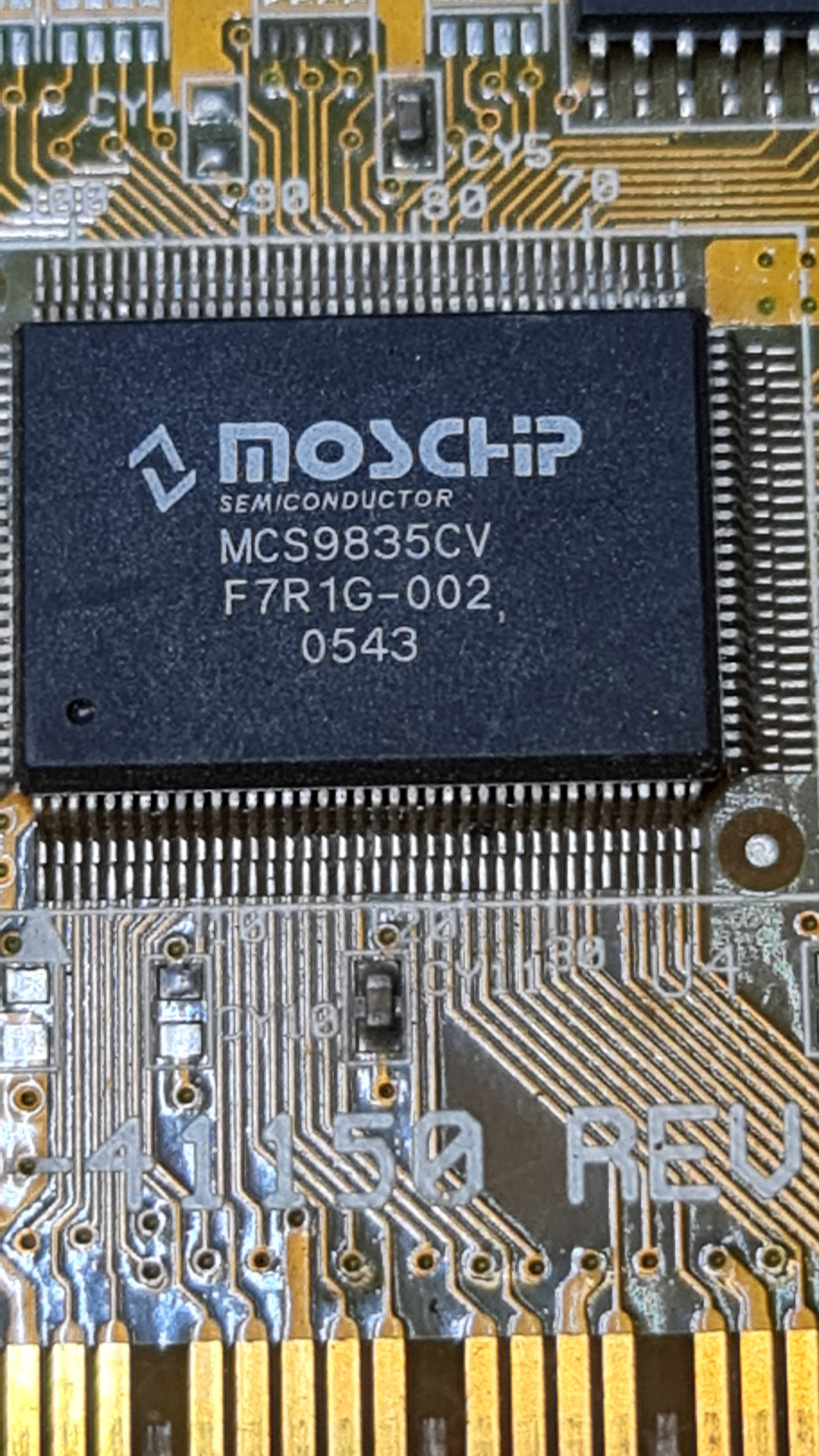

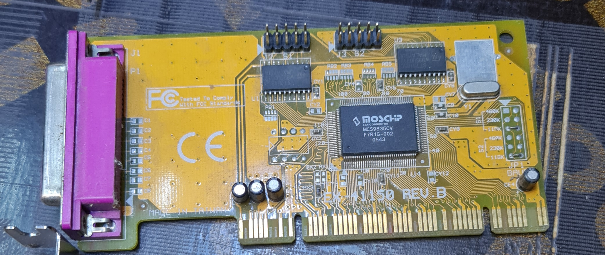

PCI to parallel card with 2 of RS232 serial port headers.
Can be found on older HP desktops, hard to find as most have been thrown to trash, but do check local repair shops, they might still be on the shelves...
Works out of the box with LinuxCNC 2.7 and above, can do OUT and IN mode, did not test X mode yet.
Comes with the long bracket and another long bracket with two serial ports.
