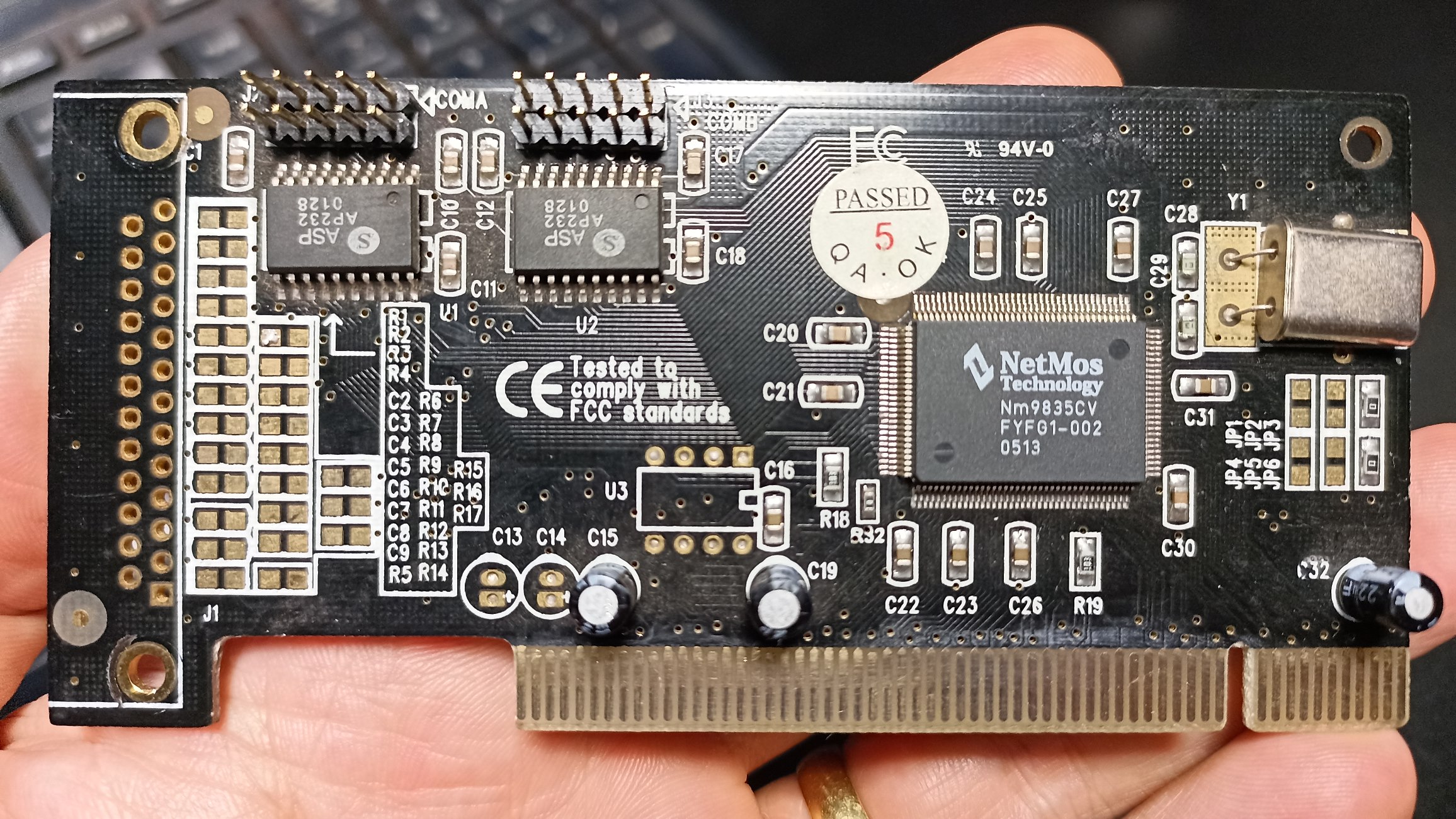

25 Mar 2025 23:13 - 25 Mar 2025 23:16 #324929
by unknown
Replied by unknown on topic PCI and PCI-E add on cards with parallel port that work out of the box
Sorry guys no pics but some info for 2 ,1 PCI & 1 PCIe (lscpi indentifies which is which) parallel from various resources on the machine. Will try later when got time to remove cards.

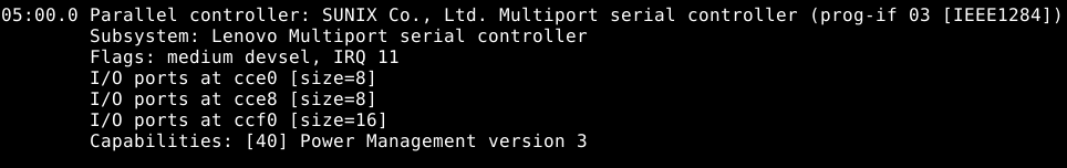

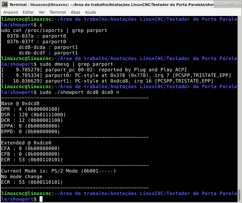

28 Mar 2025 19:14 - 28 Mar 2025 19:49 #325182
by ContinenteCNC
Replied by ContinenteCNC on topic PCI and PCI-E add on cards with parallel port that work out of the box

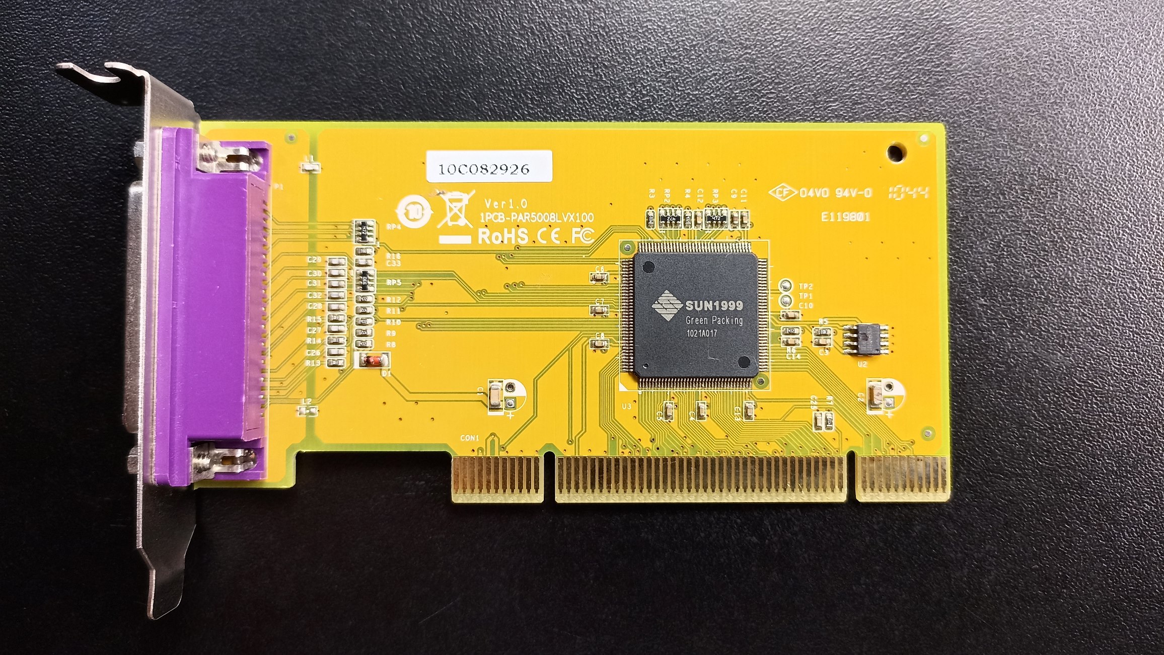

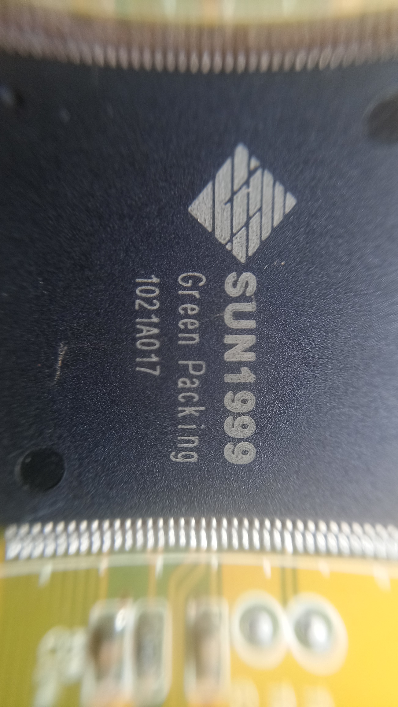

Model: PAR5008LVX100
Chipset: Sunix SUN1999
Interface: PCI
Supports PS/2: YES
Supports EPP: NOT TESTED
Supports IN Mode: YES (in PS/2 Mode)
Supports X Mode: NO (Control port pins voltage drops to ~0,3 V when connected to ground through 470 ohms resistor, but pins states won't change)
Tested OS: linuxcnc-2.8.4 / Debian Buster
Tested Computer: Dell Optiplex 760
Interface: PCI
Supports PS/2: YES
Last edit: 28 Mar 2025 19:49 by ContinenteCNC.

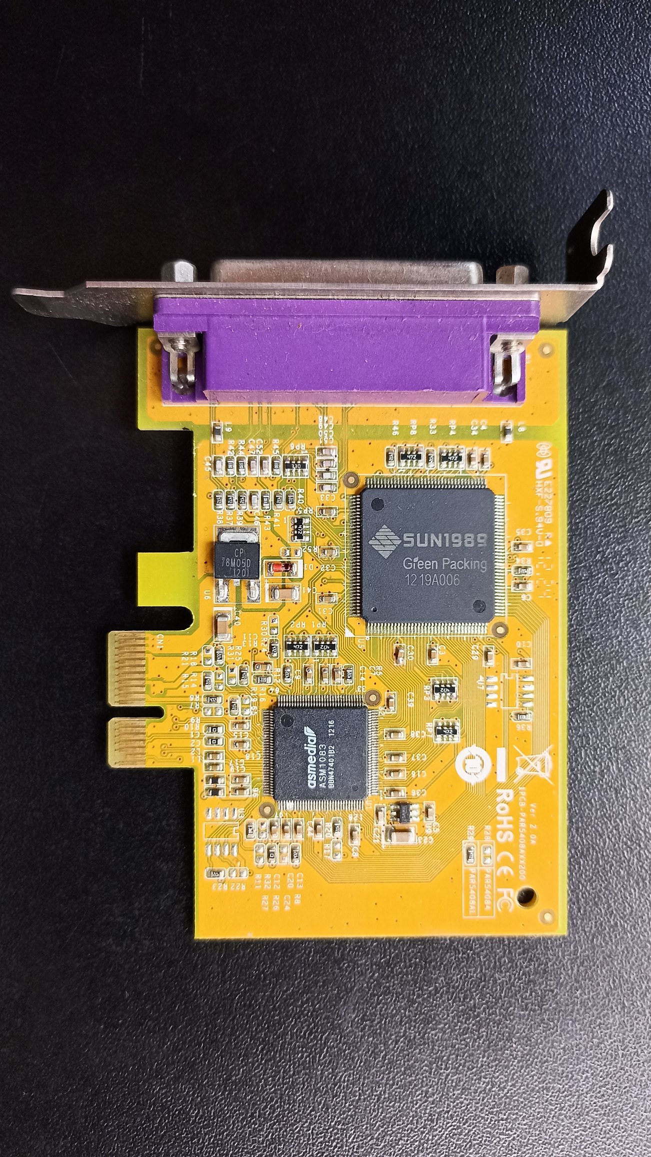

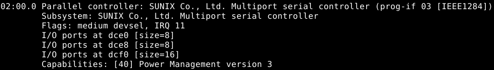

- ContinenteCNC
- Posts: 97
- Thank you received: 44
28 Mar 2025 19:48 #325184
by ContinenteCNC

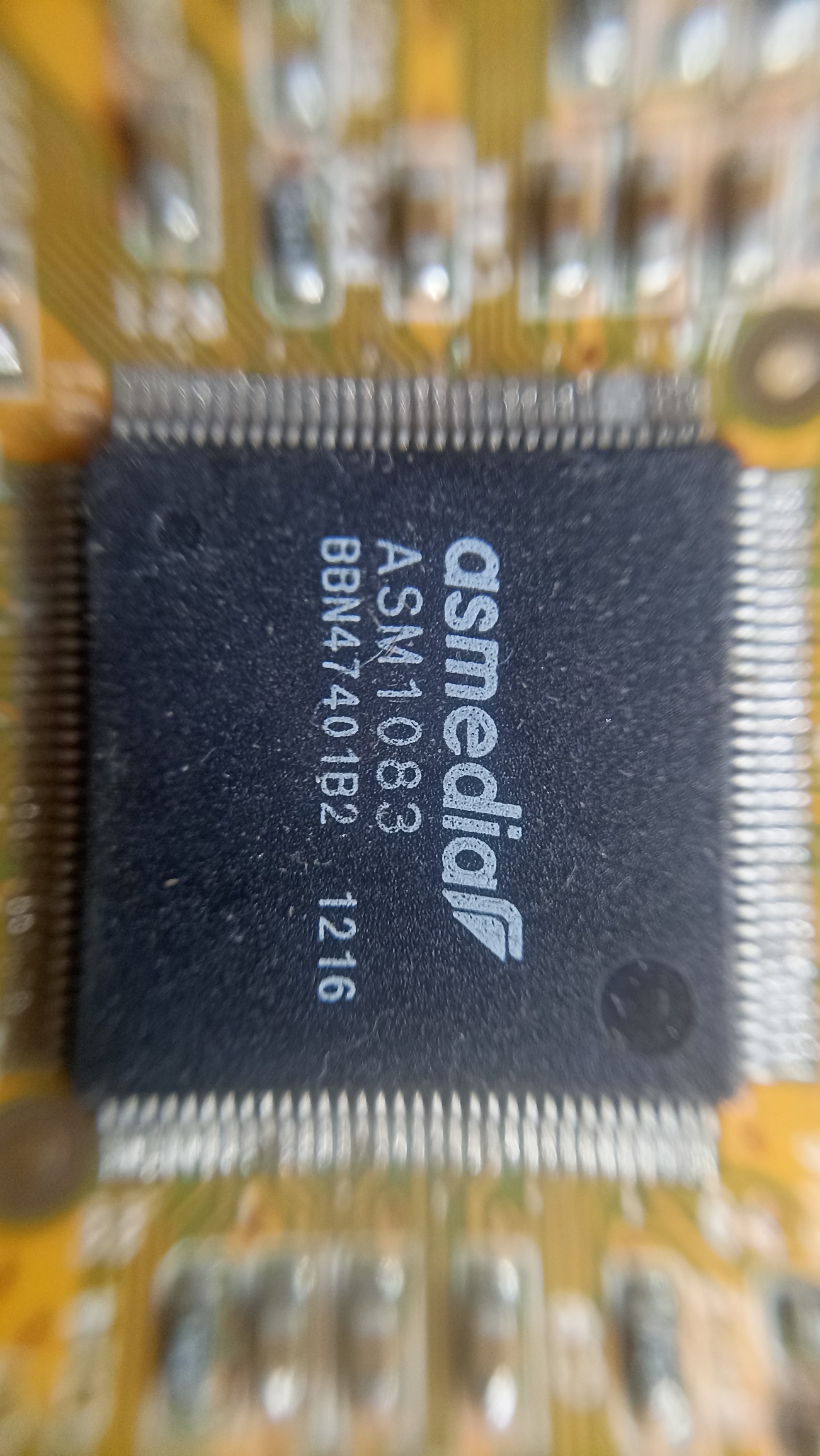

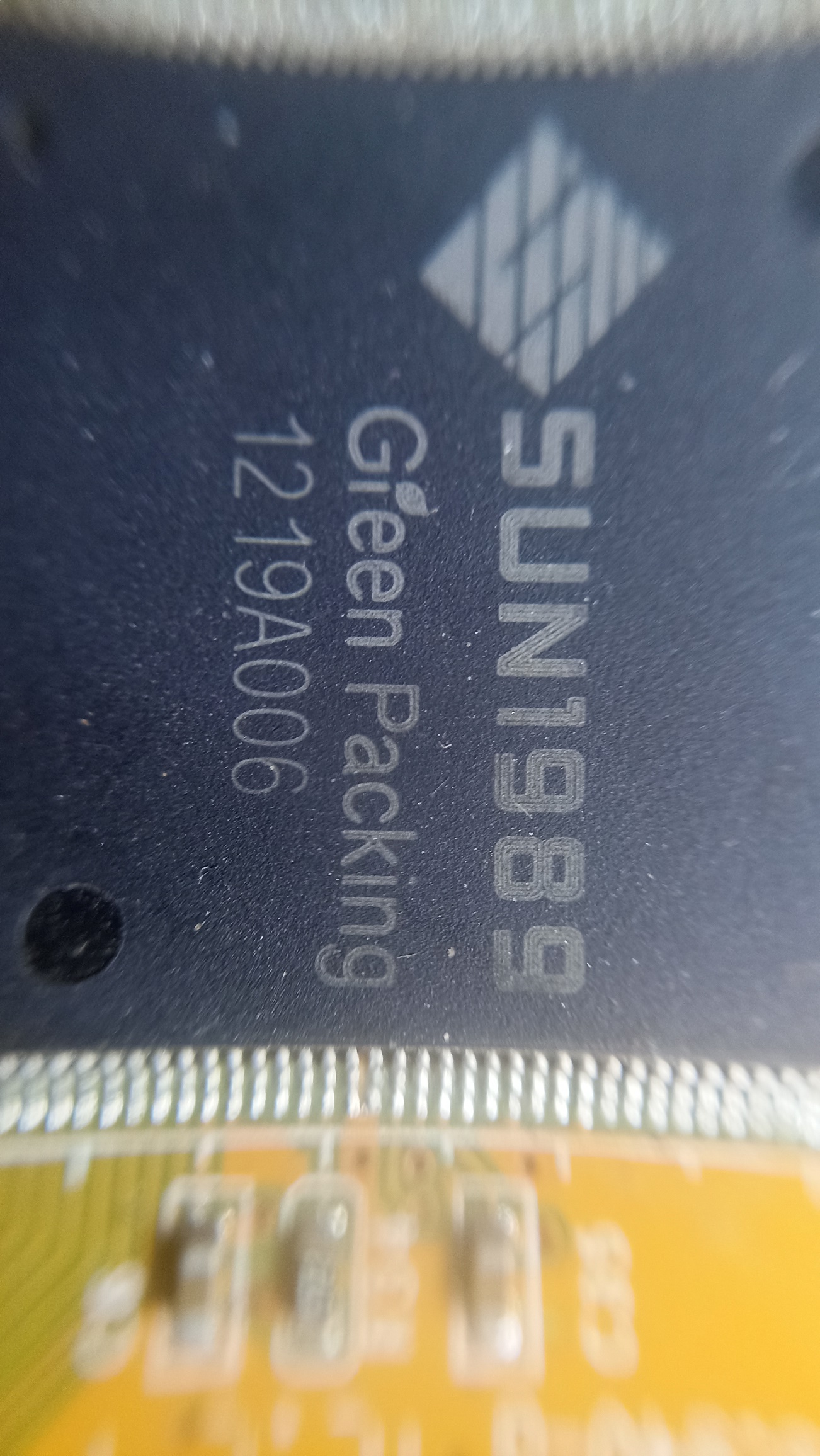

Model: PAR5408AXX200
Chipset: Sunix SUN1989
Interface: PCIe
Supports PS/2: YES
Interface: PCIe
Supports PS/2: YES

- ContinenteCNC
- Posts: 97
28 Mar 2025 20:21 #325190
by ContinenteCNC
It seems it has something to do with Sunix chipsets.
No, neither of them. The last picture in each post is everything coming out of sudo lspci -vDo they show driver and module in use?
I would guess at yes... as the flags are only "medium devsel"

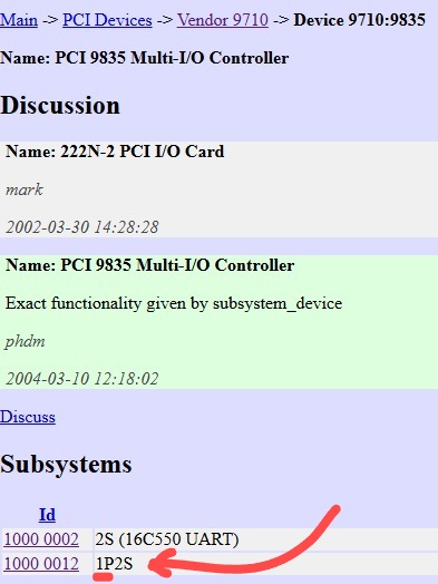

- unknown
- Posts: 887
- Thank you received: 323
28 Mar 2025 21:43 #325198
by unknown
The asm1083 is a PCIe to PCI bridge. The other chip would be the chip with the parallel etc functions.
Photos are ok, but the real bit of important info is the PCI ID number.
If you look at the text file I attached a couple of posts ago as well as having info regarding the parallel port cards it also has a couple of commands as where to get the info from the file system. Like what mode the card supports and stuff like that.
The following user(s) said Thank You: ContinenteCNC
