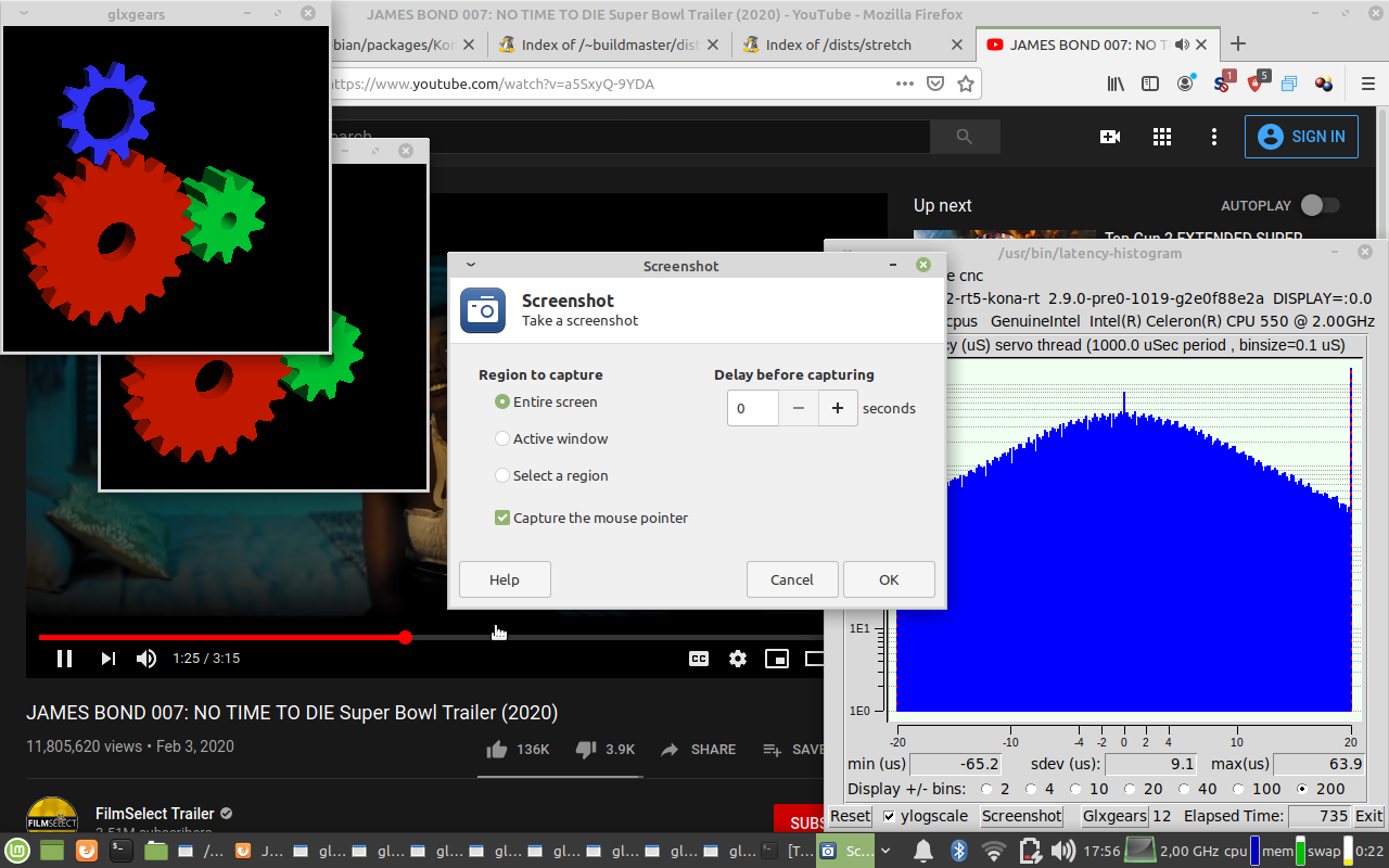

Lenovo ThinkPad R61E, built in RJ45 connector, very old
-This is with only 1Gb of RAM, Linux Mint 19.3 XCFE, kernel 4.16.12-rt5-kona-rt, single core processor at 2GHz.
-Using 4.9.47-rt37-kona-rt kernel the latency is much better, and can run Linuxcnc through ethernet connected to a 7i92 for 2 days without latency issues.
-Overall, a usable laptop for machine control, especially with more memory. No battery so no info if removing the power would cause latency errors.
Added:
Using this laptop for several weeks now, no issues so far, it works nicely and does not cause latency spikes even under load.
Added:
