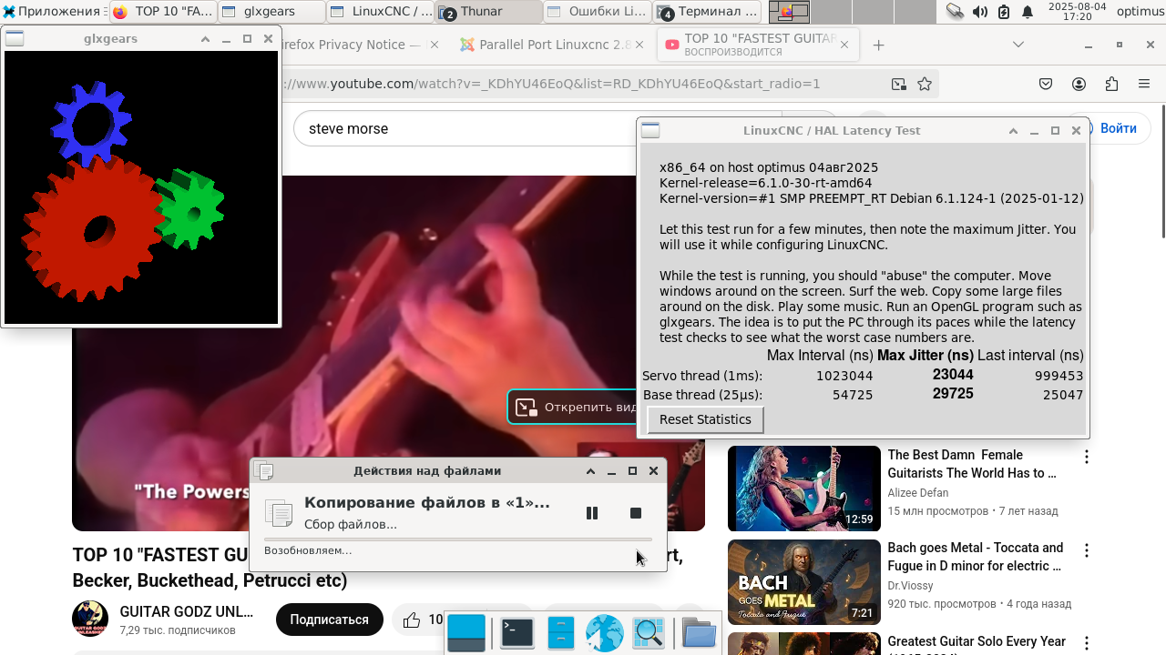

Hello. I've build a setup with ASUS prime N100I-D D4
Turned off some CPU related features in BIOS and added
to linux kernel cmdline params
"isolcpus=2,3 acpi_irq_nobalance noirqbalance"
So Max Jitter(ns) for Base thread is 29725.
Any other optimizations which I've forget about?

- Posts: 19908
- Thank you received: 4660
08 Aug 2025 15:23 #333067
Replied by andypugh on topic New PC build: Asrock N100DC
I think that's about as good as it gets, and it's perfectly usable for most purposes (especially if you don't plan on using software step generation or encoder counting)
- Posts: 12178
- Thank you received: 4155
09 Aug 2025 07:20 #333117
Replied by rodw on topic New PC build: Asrock N100DC
if Mesa or ethercat, disable energy efficient Ethernet with commands for your NIC (Intel/Realtek) and consider adjusting IRQ for the network card to prefer the core the servo thread is running one. There is a script somewhere on the forum here.
