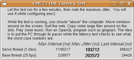

I've installed EMC/Ubuntu on an old computer (P4, 2,6GHz, 1GB ram, 5 years old) and can't run 'latency-test'. I'm getting some segmentation fault and the keyboard input didn't work anymore.

I dug up an old P3 (667Mhz, 385MB ram, about 8 years old) and latency test ran, but was not very good (max jitter base thread 195712, max jitter servo thread 202572).

For the P3, i ran the previous latency from the liveCD, after installing on HD i got to 78405/37475, after disabling power managament in the bios, removing PCI modem, second HD, floppy drive and second CD/DVD i got to 52298/32069. A lot better for testing the system, but i hope i can get it further down.
