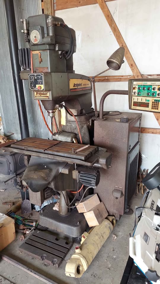

Hi everyone,
I'm hoping that someone can help me get my head wrapped around this, and point me in the right direction.  I've spent over a dozen hours reading through threads on this forum and elsewhere - yet, I can't figure out how to proceed.
My machine is a Bridgeport Series I CNC (Boss 6) mill - and it's sitting in my shop in original condition.  I'm new to CNC (having only dabbled with my Ender 3 3D printer).  However, a close friend of mine who's helping me has a couple of HAAS mills and is a guru with Autodesk Fusion.
I've investigated numerous options for updating this machine.  The more I study this, the more confused I've become!  The simplest answer for a person like me seems to be to install an Acorn board.  I'd rather not.  I don't want to get vendor-locked (more than I have to).  The thought of a company going under and leaving me in the position of having to gut the machine and start over is not appealing.  I don't want to pay a subscription.  I like the openness and configurability of LinuxCNC, and I'm a big fan and daily user of Linux (Red Hat Academy instructor).
My goals:
* Get the old Bridgeport back to making chips again.
* Have the ability to both use this machine as a CNC, and as a glorified manual machine (using LinuxCNC as a DRO).
* Not spend thousands of Dollars on this project (if possible!).

21 Mar 2025 13:34 #324415 by tommylight
Replied by tommylight on topic Hardware advice
What drives/motors does it use?
21 Mar 2025 15:11 #324422 by gm001
Replied by gm001 on topic Hardware advice
Thanks for your response!
This machine has an auto oiler on it - so that will be one of the first things I mess with to ensure it's working correctly. I've seen some people state that the oiler nozzles on these machines can become clogged with gunk from sitting for so long.
Yep, the first order of business will be to remove the two big control cabinets from it, and vacuum all of the "man glitter" off if it, and give it a bath and a lube!
I'm looking at replacing the steppers for several reasons. Based upon the information I've found about these machines on various forums:
* The steppers are an old design. They apparently ran at a higher voltage than most modern steppers. This requires special drives (like a DM1182). For less than the cost of a suitable "high voltage" drive, I can buy modern steppers with matching drives and power supplies:
www.omc-stepperonline.com/ys-series-3-ax...ower-supply-3-clys90
* Given the age of the steppers, many people are stating that they are likely weak - due to the age of their magnets and the type of magnets they used.
* From what I understand, these steppers are not closed-loop.
* Again, according to others, these steppers are "notchy" and "jumpy". They aren't as smooth as modern steppers, and don't have the accuracy/resolution (though, they are probably plenty accurate for my needs).
I'm sure that some "Double-E" out there could figure out how to connect a RPi's GPIO to the existing stepper drives. However, that's well beyond my level of expertise. The existing drives are cards that are plugged into a sort of backplane. They have Bridgeport's name on the boards, so I assume that they are proprietary. There's a document floating around, which explains how to reuse the existing stepper drives and steppers with Mach 3:
manuals.chudov.com/Bridgeport/Series-I/H...Boss_6_to_Mach_3.pdf
This looks like something I could absolutely do (substituting LinuxCNC for Mach 3). I could pick up one of Byte 2 Bot's parallel port hats, and run a BoB to drive the original Bridgeport electronics. However, it also seems like a lot of work to go through - just to rely on ancient, obsolete drives, steppers, and power supplies. In the end, I have an "oddball" system that is difficult to support. These original drives were also known to run pretty hot.
21 Mar 2025 15:33 #324425 by gm001
Thanks for the response!
The original drives are Bridgeport cards plugged into a backplane and mounted to a three foot heatsink. These apparently take "quadrature" inputs - not "step and direction?"
I'm not sure who made the original motors. I've been unable to find any markings/tags on them (maybe I need to unscrew the back plate, and look inside?). From what I've read, Bridgeport used a couple of different brands of steppers on these - either "Sigma" or "Superior." Apparently, they are "high voltage" steppers, and require a "high voltage" drive to run.

22 Mar 2025 09:03 #324527 by Hakan
Replied by Hakan on topic Hardware advice
Just my take on it. There are many ways to run linuxcnc, keep that in mind.
My questions:
* What should I run LinuxCNC on?  I've got a spare RPi 4 sitting in my drawer.  I've got a couple of Supermicro Intel Atom-based ITX server motherboards lying around.  What's the most intelligent way to go?
Atom is probably below the acceptable performance limit, but anything faster than that. There are some new mini-ITX main-boards with N100 integrated. CPU performance is more for the user experience, the later HMIs (or guis) may need a bit faster CPU, while the old Axis works with anything. For the cnc part it is about real-time jitter and there usually are ways to tweak settings to come to low jitter. I go with N100 nowadays, but its just one of many possibilities. Once you have seen the newer guis you will want to use one of those. And need at least some CPU performance. I ran on RPi4, I would think a step up to RPi5 would be nice.
* It seems that a parallel port interface is the "old-school" way of doing things.  Now, it seems that most prefer an Ethernet interface.  Is there a disadvantage of going one way or another?
Stepper performance (steps/seconds), number of IOs, and other types of IO than digital IO is what makes people move away from the parallel port. Plus that main-boards nowadays seldom have a parallel port and need to have one added.
* Since I have to replace the steppers anyway, is it foolish to go with a "traditional" setup rather than Ethercat?  It seems like Ethercat will be considerably more expensive (like twice the price or more) - but is it worth the price?
You won't get anything extra from the milling machine using EtherCAT. It is a different way of doing the same thing.
* Everyone seems to agree that Mesa boards are the "gold standard."  How do Pico Systems' boards compare?  Jon Elson lives like 20 miles from my house.  Does anyone have experience with his customer service?  Is it foolish to consider anything other than a Mesa?
From what I can see, and I may be wrong, the Pico Systems' board connect to the parallel port? If you go with a parallel port solution that can work. Mesa's board on the other hand typically use EtherNet, SPI, PCIE, or PCI (and maybe more) to connect to the computer. This gives speed and reliability.
* If I go with a Mesa setup, which direction should I go?  If I use the RPi, I could go with the 7C80 or 7C81 - I could also run an Ethernet setup.  If I use the server motherboard, I could go with a parallel port setup or an Ethernet setup.  Is there an advantage of going one way or another, here?
I've only used Ethernet setup and see few reasons to do anything else. If you are only ever to use Raspberry one can think of the 7C line. I would like to keep all options open as far as possible.
* If I go with a given Mesa board, what else will I need to buy?  It seems that some of the Mesa cards (like the 7C80 and the 7I95T) will hook directly to the stepper drives, while others require a separate daughter card (BoB)?
Send Mesa a mail with those questions, they are usually very happy to help. For a normal stepper motor system I would look at 7i96, which connects to the stepper driver with the step/dir/enable signals.
* What hardware (if any) would I need in order to use the encoders on the steppers as a DRO?  Will any of my hardware selection above affect my ability to have this feature?
For Mesa to answer, I think you are looking at a 7i85. From what I understand, encoder counting is done by the FPGA, so the card must either do it itself on the FPGA board, or have a connector that allows a daughter board to connect the encoder inputs. The 7i96+7i85 does that.
* Will a cheap Amazon/Aliexpress stepper motor/drive/power supply set work, or will I need to buy the stepper drives separately?  If I need a particular stepper drive, should I go with a Gecko or something else?
Yes, will work fine, just size it to suit the stepper motors. I have good experience with such stepper drives.
* If I run a touchscreen and a pendant, is there any reason why I will need a keyboard hooked up to this machine (once it is configured)?
Depends on the gui and how well touch screen input is integrated. For example, I run the qtdragon gui and there the keyboard input is well integrated. Except when I need to edit the G-code file, then I bring in the keyboard. Normally I have it tucked away though.
