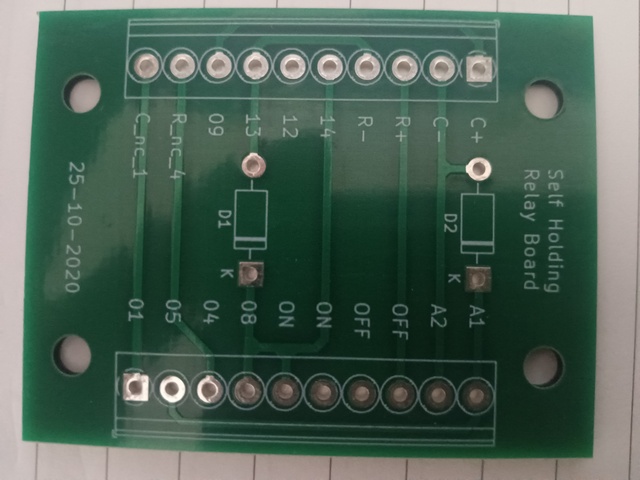

Here's an explanation of "Latching Relays", which is what my schematic shows. I made up some PCBs to make the connections easier.
www.pcbway.com/blog/PCB_Basic_Informatio...Relays_d665ce9b.html

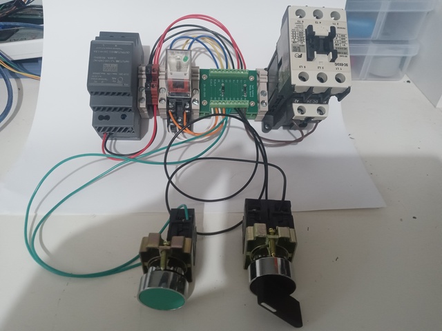

07 Apr 2025 02:48 - 07 Apr 2025 02:54 #325858
by unknown
Replied by unknown on topic 4-Gang 1-Way Switch To Control 3 Power Supplies and a Router Independently
I thought I'd add some pictures - PSU - Dinkle terminals - relay - lazy wiring board - contactor - Monetary NO push button to energise relay (SW1in schematic), rotary type switch to control power to circuit (SW2 in schematic). In my control panel the contactor is not mounted close to the relay but closer to the power supply supply minimizes the length of the AC power cables. This was just quickly thrown togther for demo purposes, in the cabinet it's more professional looking.
And a close up of the lazy wiring board, diodes are snubber diodes. Wiring is so much easier. Relay & contactor can be same or different voltages, hence the R+ & R- and C+ & C- points on the board. The 240AC is wired directly to the terminals on the contactor.
