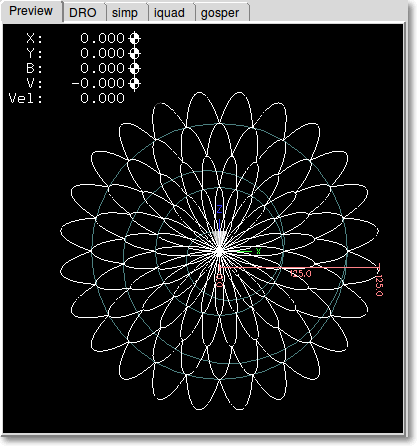

I I wondered if it would be possible to write a simple rose engine entirely as a g code program that would run directly on emc. So I gave it a go and the resultant code + documentation can be found on my blog.
blog.alanbattersby.co.uk/software/g-code...se-engine-simulator/
Of course there is no user interface but emc's pre-plot will show the cutter path.
The basic functionality is
1) Two spindles each holding up to 20 rosettes. Rosettes on a spindle can be blended together.
2) Seven types of rosette
3) A geometric chuck with up to 20 stages where each stage is defined by a rosette.
I would welcome any feedback, notification of bugs etc.
Alan
Emc pre-plot of an example pattern
