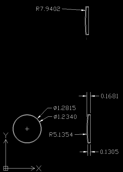

Been trying to get a handle on circular interpolation and it doesn't seem EMC is playing fair with a newb! It doesn't seem to matter how I structure the G3 statement I always get a "radius to end of arc differs from radius to start:" error.
I have plotted the radius of the surface in Autocad and a drawing is attached. I am trying to learn how to use this statement and cryptic errors aren't making it easy!

04 Feb 2012 08:36 - 04 Feb 2012 08:38 #17384 by andypugh
Are you using relative or absolute coordinates for the arc centre? (This is set using G90.1 or G91.1) www.linuxcnc.org/docview/html/gcode_main.html#sec:G90.1,-G91.1
Do you have the correct plane selected?
Typically G17 for a mill(XY) and G18 for a lathe(XZ)
Also, on a lathe radius/diameter mode can confuse matters. (G7, G8)

04 Feb 2012 16:05 #17398 by ArcEye
This is the .dxf image

04 Feb 2012 17:56 #17400 by BigJohnT
I assume your trying to cut the radius in the lower right hand corner? What is the orientation of the cut as far as X and Z are concerned?
John
04 Feb 2012 18:07 #17401 by justinbowser
Replied by justinbowser on topic Re:Error when using circular interpolation on lathe
Yes, the cutting would be in the lower R/H quadrant with the tool moving in a CCW direction as viewed from the top. This snippet assumes that the rod has already been faced off and Z touched off on the face and that it has been turned down from 1.5" to 1.2815"
04 Feb 2012 18:09 #17402 by BigJohnT
The Z part does not make sense to me... when I lay it out it is 0.1626 difference between start Z and end Z.
John
04 Feb 2012 18:17 #17403 by justinbowser
Oopa! I made a typo in my error message.. It should have read:
start =(Z-0.0376, X1.2815) center=(Z-5.1354, X0.0000)
