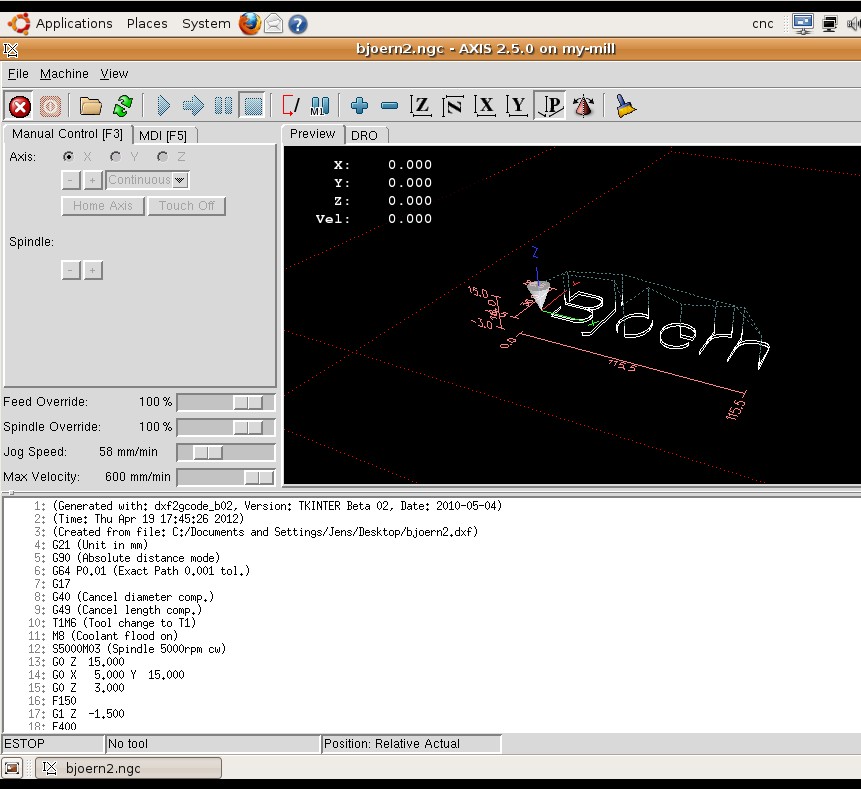

I did some 2D with draftSight on Xp and used a tool to generate the G-Code - however, in LinuxCNC I can see that the the code is generated twice with different Z value. Why is that and how can I prevent it? Or better, how can I modify it and add more Z layers in case I have a thick workpiece?

no video link , so i can only guess at this stage
code generation is done from the gcode cam generator , LinuxCNC does not generate the code , it acts upon it ...
but what you may be seeing is the offset tool path , i.e the origional generated gcode path and then the actual path the tool takes to produce
which cam program are you using to produce the gcode ?
the cut depth of the z axis is set in your cam program .
post a drawing and your gcode and we can advise

Was the youtube link removed? If so I don't want to post it again. So just go to youtube and search for "How to make a simple gcode" - the video I mean is from zkazka123 (not mine).
I used this time GSimple (on Xp), but the effect is the same. Now I like to remove the 2nd layer, but later I may want to add more layers in case I have thicker material.

Depending on the program that generated the tool path if you need to cut say 1/2" thick and you have a setting of a maxium cut depth per pass of say 1/4" the program will generate two tool paths,
one at 1/4" deep and then a finish cut of 1/2" deep.
To avoid this either set your maxium cut at 1/2" or your depth at 1/4" deep or less.
Rick G
Replied by Rick G on topic Re:Why G-code is generated twice with different Z ?

whoops, I guess wrong file format. I like to investigate it a bit further myself. Certainly my error somewhere.
