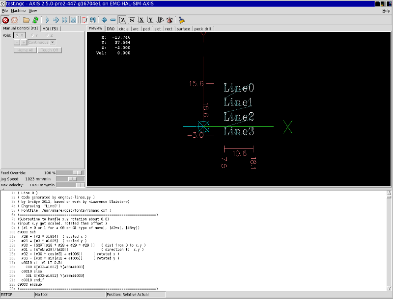

and test.ngc will look like this in Axis
It takes a bit of time to work out what your line offsets need to be and the best starting point X and Y to balance the text on the workpiece, but once you have that sorted you can fly through
I generated all the code required to engrave a further 19 plaques, whilst the mill was engraving the first one!

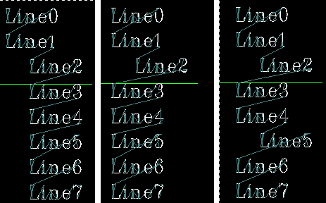

- ArcEye
- Posts: 22
- Thank you received: 240
20 Jun 2012 16:10 - 26 Oct 2014 22:41 #21154
by ArcEye
Replied by ArcEye on topic Re:Multi-line text engraving g-code generator
Hi
AMENDED - see subsequent posts for new downloads
Having used my program for a while, I decided that something needed to be done with the X offset value.
As it stood, if this value was applied, each line would be indented by XLineOffset from the previous one
which started to lose usefulness after 2 lines unless engraving on a slanted face.
When engraving several lines of text, the generally most useful thing to be able to do is to indent lines.
Accordingly I have added functionality which allows any lines specified in a string
eg -i'1357'
to be indented by the -x X offset
The built in help now covers these options
Examples are shown in screenshot
Indent 234567 -i'234567' - Indent only line 2 -i'2' - Indent lines 2,5 -i'25'
regards
(File in later post)
eg -i'1357'

Example engrave-lines.py -X7.5 -x5 -i'123' -Y12.75 -y5.25 -S0.4 -s0.5 -Z2 -D0.1 -0'Line0' -1'Line1' -2'Line2' -3'Line3' > test.ngcExamples are shown in screenshot
