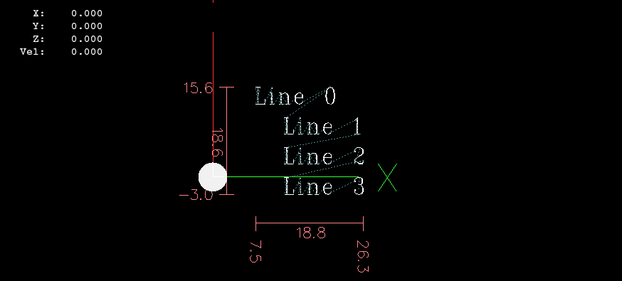

engrave-lines -X7.5 -x5 -i'123' -Y12.75 -y5.25 -S0.4 -s0.5 -Z2 -D0.1 -0'Line 0' -1'Line 1' -2'Line 2' -3'Line 3' > test.ngc
produces
Suggest you re-install and make sure you have the fonts from the zip, not anything qcad provides.
