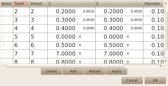

I should have made this final post last september when we finally, after 2 long years of work, got everything ironed out, and working as it should. This is how most all "commercial CNC" turning centers handle a tool change, using fixed and assignable offset values.
We have three turning centers running this, and it works perfectly
You need to modify your remap.py adding the following,

Then as for the tool table, you need to add tool numbers 10001-10008. This is were the "wear offset" values would be placed, these are the second 2 digits of the tool call.
Rick

15 Apr 2015 09:34 #57811
Replied by cmorley on topic Re:Tool offset patch
Lairs:
I wondered if a modified tool_edit widget would be better for lathes:
The wear number is beside the offset rather then as a separate tool.
interested? It's not quite done yet...
Chris M
Chris M
