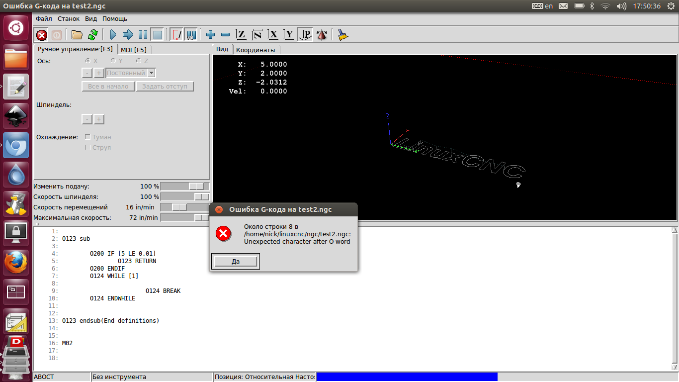

Hi while developping LinuxCNC features we saw some strange behavior of subroutines...
1. Oxxx RETURN works strange:
This code gives "Unxepected character after O-word"
If we remove "O123 RETURN" or WHILE code is accepted.
2. This is more complicated example.

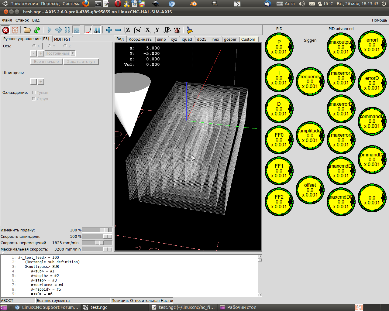

It's a subroutine which shuold generate rectangle pocket with multipass spiral milling of rectangle.
So we have two subs
first <multipass> sub - it makes passess for mulptipass machining
second spiral rectangle.
So here's the deal: in multipass sub there's O#<sub> CALL - a call to the sub defined in #<sub> parameter. And it does not work. It says that #<sub> parameter is undentified, dispite the first string of the sub #<sub> = #1.
We have tried several variations:
O#<sub> CALL [#8] [#9] [#10] [#11] [#12] [#13] [#14] [#15] [#16] [#17] [#18] [#19]
- does not work!
O#1 CALL [#8] [#9] [#10] [#11] [#12] [#13] [#14] [#15] [#16] [#17] [#18] [#19]
- works fine!
#<sub> = #1
- does not work!?!?!
How can it be?
Code:
O123 sub
O<200> IF [5 LE 0.01]
O123 RETURN
O<200> ENDIF
O124 WHILE [1]
O124 BREAK
O124 ENDWHILE
O123 endsub(End definitions)
M02

the whole subroutine:
Code:

O<multipass> CALL [#<_spiral-rectangle>] [-5.1] [1] [0] [10] [5] [2] [1] [1] [10] [20] [.1]
M02
This subroutine should give something like this:
Last edit: 13 years 5 months ago by Nick.
