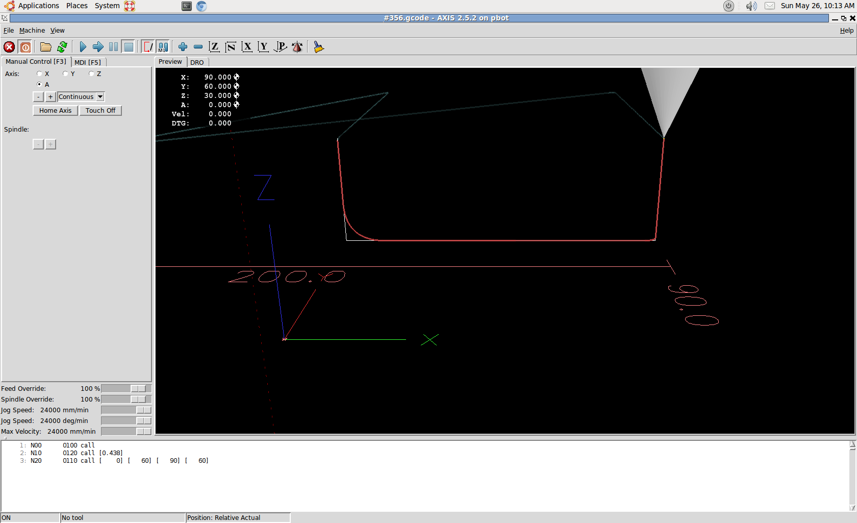

I run the following gcode and get this path. What surprises me is that the leadin (left side) deviation from the path is greater than the leadout (right side). I would expect it to be symmetrical.
G64 P5.0 Q1.0
G0 x[0.000000] y[60.000000] z[30.000000] a[0.000000]
G1 x[0.000000] y[60.000000] z[0.000000] a[0.000000] F20000
G1 x[90.000000] y[60.000000] z[0.000000] a[0.000000] F20000
G1 x[90.000000] y[60.000000] z[30.000000] a[0.000000] F20000

Your gcode in your screen shot doesn't match what you posted
Could you post the whole gcode program?

It does match. The o-code (line N20) gets translated into exactly the gcode posted. Look at the move XYZA coordinates and the end position shown in the window.
Also, I verified by creating a separate file with just the gcode I posted and ran that alone - identical results.

This behavior is due to the Z-acceleration being lower than the XY-acceleration.
