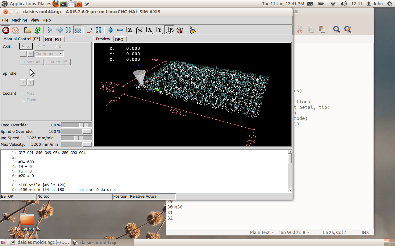

Matrix sorted.
G17 G21 G40 G49 G54 G80 G90 G94
#3= 600
#4 = 0
#5 = 0
#20 = 0
g00 x[0] y[0] z[20]
o100 while [#5 lt 120] (column of six daisies along y axis)
o150 while [#4 lt 180] (line of 9 daisies along x axis)
o200 do
g10 l2 p1 x[#4] y[#5] r#20 (set zero position)
g00 x[10] y[0] (1st petal tip)
z[0] (work surface)
g91 (incremental mode)
g01 x[-2.4] z[-2] F#3 (cut 1st petal)
g01 x[-4.6] z[2] F#3
g90 (absolute mode)
g00 z[5] (clearance)
#20 = [#20 + 30]
o200 while [#20 lt 360] (finish daisy)
#20 = 0
#4 = [#4+20]
o150 endwhile (finish row)
#4 = 0
#5 =[#5+20]
o100 endwhile (finish matrix)
g00 z[20]
g00 x[0] y[0]
m30
So you can nest while/endwhile at least three times !
All that is left is to change tool and add the centres. :)

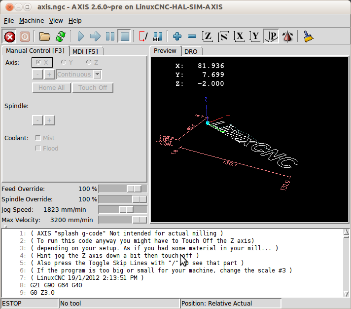

Slight problem getting used to using a G10 L2 P1 code.
If G10 is used, I believe the setting is retained at the end of the program, and will affect any subsequent programs, even after a reboot.
It certainly seems to be on my set up.
What is the cleanest way to prevent that happening ?
Is it to include a line at the end of each progamme like G10 L2 P1 x[0] y[0] z[0] , or put that at the beginning ?
Or is there a better way ?
I'm sure the relevant info is somewhere in the documentation, but these old grey cells are beginning to ache :unsure:
John
17 Jun 2013 04:40 #35723 by grey1beard
Replied by grey1beard on topic Rotating a profile - 'flower arranging' !
This is now driving me up the wall.
Using the sim on my laptop, I've been using trial and error to get the test cut of my daisy(now changed to 16 petals) to run.
Having loaded the file, whenever I now re-open axis, the Linuxcnc example is rotated !
(see attached)
If someone can please tell me how to neutralise this, perhaps I can solve my other problem !
John
  • skunkworks
  • Away
  • Moderator
  • Moderator
17 Jun 2013 05:10 #35724 by skunkworks
Replied by skunkworks on topic Rotating a profile - 'flower arranging' !
I would think a g10l2p1x0y0z0r0 at the end of your program (or in MDI when you want to start fresh)
The following user(s) said Thank You: grey1beard
17 Jun 2013 14:10 - 17 Jun 2013 14:21 #35734 by grey1beard
Thanks skunkworks. I hadn't been including the r[0] ,and that is probably the key !
Regards
John
EDIT Just run a test on sim, and that did the trick. I had to run the program fully, then closed Axis down. Reopened Axis, and the Linuxcnc file now shows with the normal orientation.
