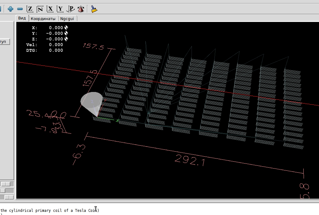

Hello everybody, I have written a g code file comprised of subroutines designed to provide a quick and easy way of creating supports for a coil make of copper pipe on a CNC. I tried to load the file in LinuxCNC, and I received a message that said "Near line 70 of primary cutter.ngc: unknown operation." I think the error is being triggered by the "o110 if" code on line 69, because the code "o<turn> call" appears earlier in the file without causing any problems. Can somebody tell me if I have correctly identified the problem here, and if so, how I could fix it? I have looked at the LinuxCNC documentation page for o-codes and cannot find anything wrong with that line of code. The file is attached.

18 Jun 2013 03:53 - 18 Jun 2013 04:14 #35756
by nkp
gentle.compilertools.net/book/relations.html
Replied by nkp on topic "Unknown operation" error from an "if" statement
(if we are cutting the first support, cut an extra notch for the nth turn)
o110 if [#<_nsupport> eq 0]
o<turn> call
o<cut> call
o110 endif

18 Jun 2013 05:37 #35758
by BigJohnT
Replied by BigJohnT on topic "Unknown operation" error from an "if" statement
I don't see a o<support> call and it is the outer loop.
