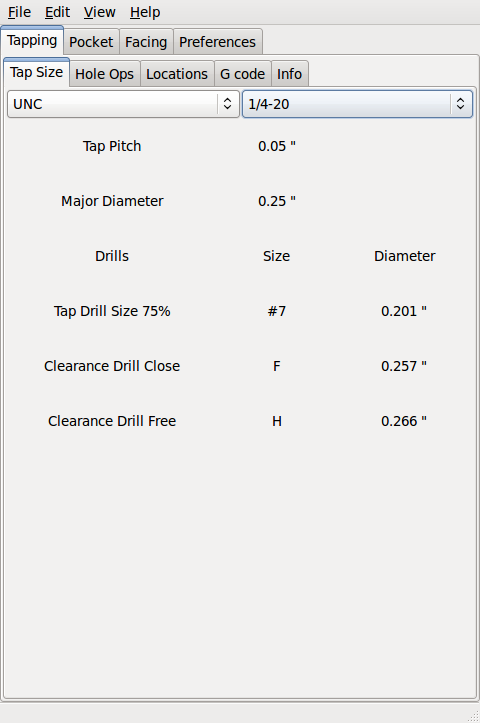

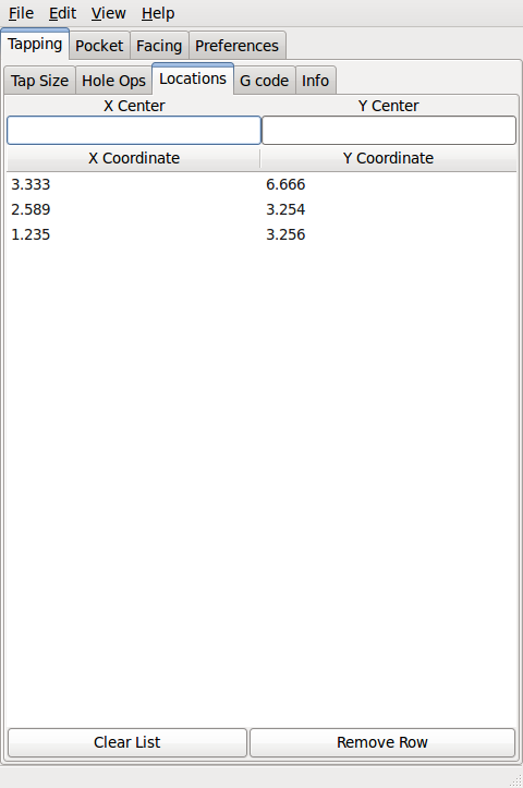

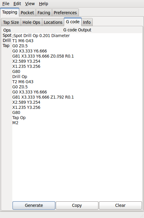

I'm working on a Python Gtk G code generator for a mill. It is in it's infancy but if anyone cares to look at it... and I am mildly curious if it runs on other distros than Ubuntu 10.04?
gnipsel.com/files/mill-g-code/
Version 1.7.7 is current and the version is located in help > about
Tap Selection page is finished
Hole Ops page is finished
Locations page is finished
G code page will generate:
Preferences page all entries are working
If anyone actually looks at it you will notice two things missing from the G code...

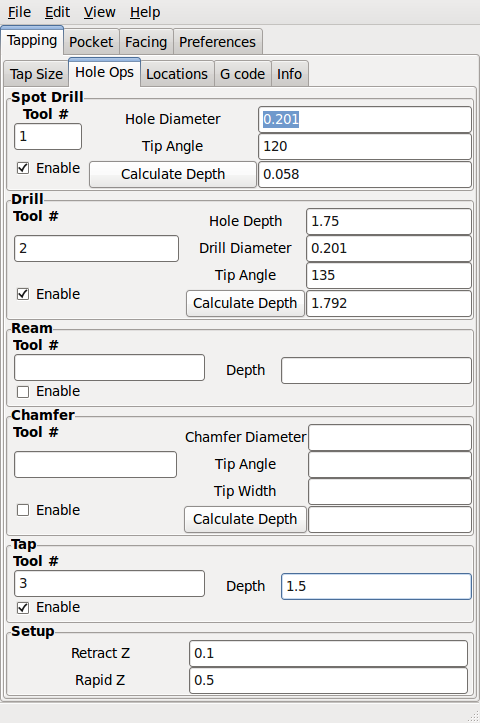

24 Sep 2013 19:07 #39161
by BigJohnT
Replied by BigJohnT on topic Mill G code Generator
I did some arranging on the Hole Ops tab if anyone looks at this let me know if you think the Spot section is clear and has everything needed.
JT
