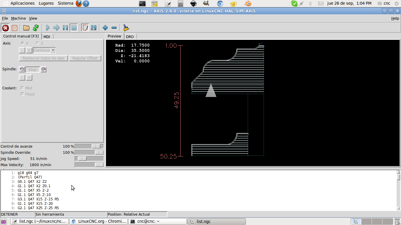

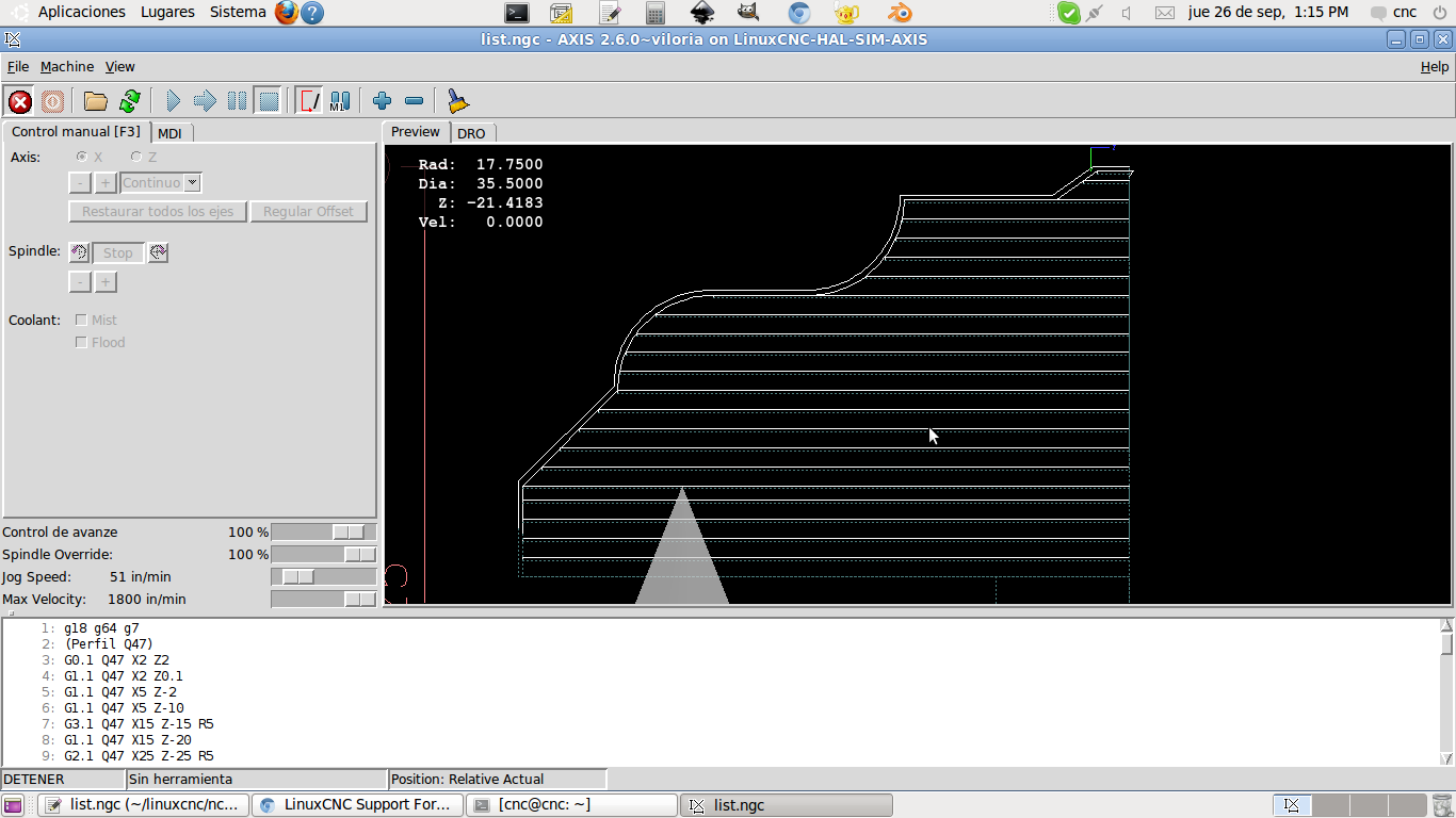

Continuing the search for the solution to the problems of my lathe.
The posting for inspection, test, criticize or improve.
At the moment only for external profiles, unfortunately not modal, for now.
The constant cutting depth, the depth varies agree programmed cutting.
I have some concerns that I could not solve,
1) when an error in the programming and chasten the program does not take change well, I have to close and reopen LinuxCNC, so assume correctly.
2) how I can make modal coordinates??? they are not repeated in each block.
3) I hope some suggestions to get better work.
Example=
g18 g64 g7
(Perfil Q47)
G0.1 Q47 X2 Z2
G1.1 Q47 X2 Z0.1
G1.1 Q47 X5 Z-2
G1.1 Q47 X5 Z-10
G3.1 Q47 X15 Z-15 R5
G1.1 Q47 X15 Z-20
G2.1 Q47 X25 Z-25 R5
G1.1 Q47 X35 Z-30
G1.1 Q47 X40 Z-30
(Ciclo de desbaste Q47)
G0 X45
Z2
G71 Q47 P1 R0.3 i0.5 k0.2 F1500
(Perfil Q48)
G0.1 Q48 X80 Z-5
G1.1 Q48 X80 Z-10
G3.1 Q48 X90 Z-15 R5
G1.1 Q48 X90 Z-30
G1.1 Q48 X100 Z-30
G0 X100
Z-5
G71 Q48 P1 R0.3 I0.5 K0.2 F1500
(Ciclo de acabado Q47)
G0 X45
Z2
G70 Q47 F1500

06 Jun 2016 20:20 #75582
by fixer
Replied by fixer on topic G71, G70 cycle for lathes (first tests)
This looks interesting. Have you done some more work on it? Have you solved the bugs? How do you handle pockets?
