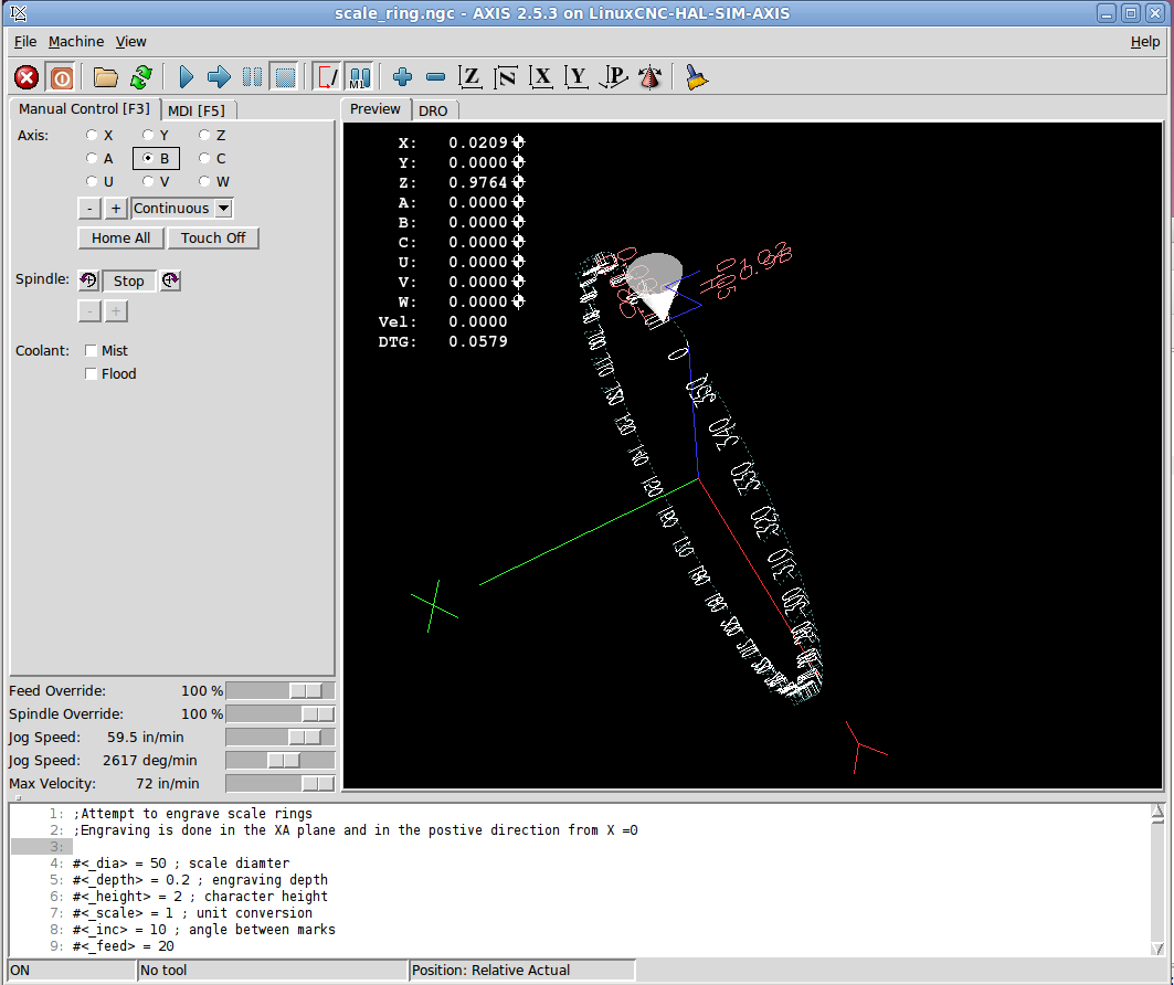

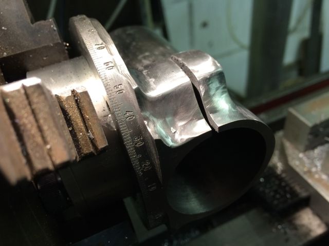

I wrote this G-code to engrave angles on a lathe part. It might be handy for other things. It uses a sub for each digit, then computed-calls to call the right one.
;Attempt to engrave scale rings
;Engraving is done in the XA plane and in the postive direction from X =0
#<_dia> = 50 ; scale diamter

Andy, thank you for replying to my IRC query. My setup -- 10.04, 2.5, stock sim_axis9 and stock sim.ini and your g-code above --- produces a tool that only moves in X and Z. It appears that the DROs change appropriately, but not the display. If it is convenient, could you let me know if you there are any configuration or other changes I should look at?
- Posts: 19914
- Thank you received: 4663
29 Jan 2015 20:30 #55458
I just tried it in the stock sim/axis-9-axis config and it was as you describe.
I changed GEOMETRY to ABCXYZYVW and then on restart the display looked as-shown in the picture above.
Replied by andypugh on topic G-code to engrave numbers on cylinders

Crud, I tried:
[TRAJ]
AXES = 9
COORDINATES = A B C X Y Z U V W
HOME = 0 0 0 0 0 0 0 0 0
LINEAR_UNITS = inch
ANGULAR_UNITS = degree
CYCLE_TIME = 0.010
DEFAULT_VELOCITY = 1.0
DEFAULT_ANGULAR_VELOCITY = 45.0
POSITION_FILE = position9.txt
MAX_LINEAR_VELOCITY = 1.2
MAX_ANGULAR_VELOCITY = 90.0
No joy. (using LinuxCNC 2.6.5 on Wheezy)
[TRAJ]
AXES = 9
LINEAR_UNITS = inch
CYCLE_TIME = 0.010
- Posts: 19914
29 Jan 2015 20:56 #55461
[DISPLAY] GEOMETRY not [TRAJ] COORDINATES
Crud, I tried:
[TRAJ]
AXES = 9
- Kirk_Wallace
- Posts: 25
29 Jan 2015 21:05 #55462
by Kirk_Wallace
Replied by Kirk_Wallace on topic G-code to engrave numbers on cylinders
UUUUUGGGGHHHH, It's working now. Sorry about that.
