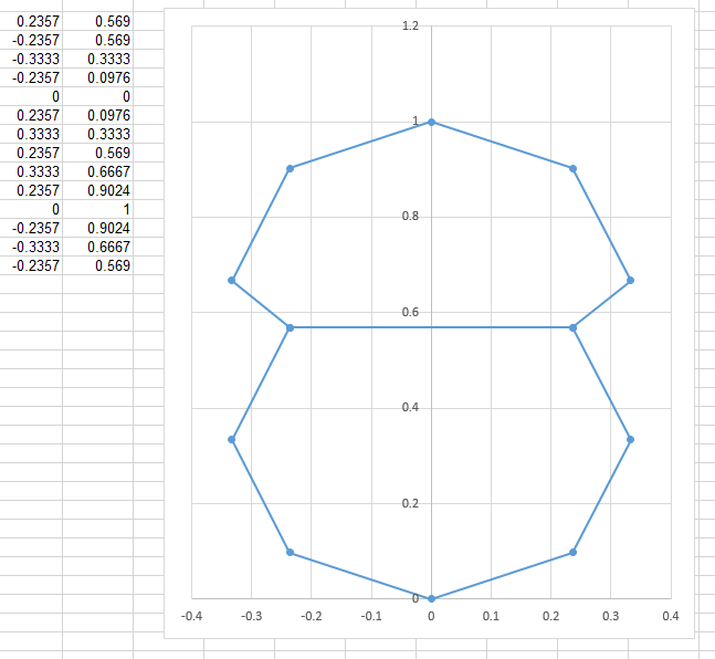

This might not be too hard, you only need a few extra letters (B,o,l,t,n,r,a,s)
But: The point of this routine was to generate the numbers on-the-fly for scale rings of various types (0-360, -180-180, 0-10. 0-25 etc)
For engraving the same words many times it is probably sensible just to use a CAM system like Fusion360 to create the G-code once :
If you want to use this G-code, then it might help to explain how it works.
Each number is created by joining points on two octagons. (generally). I worked out the coordinates of the required points, typed them in (probably in Excel) and then formed them in to the subroutines (again, probably using Excel, but it was quite a while ago)
This is the number 8
The factors #41 and #42 are used to scale in the A and X directions. Here are the points plotted in Excel:
You would Need to create the letters you need in the same way, and form them into a subroutine looking like the existing digits.

O8 endsubThe factors #41 and #42 are used to scale in the A and X directions. Here are the points plotted in Excel:

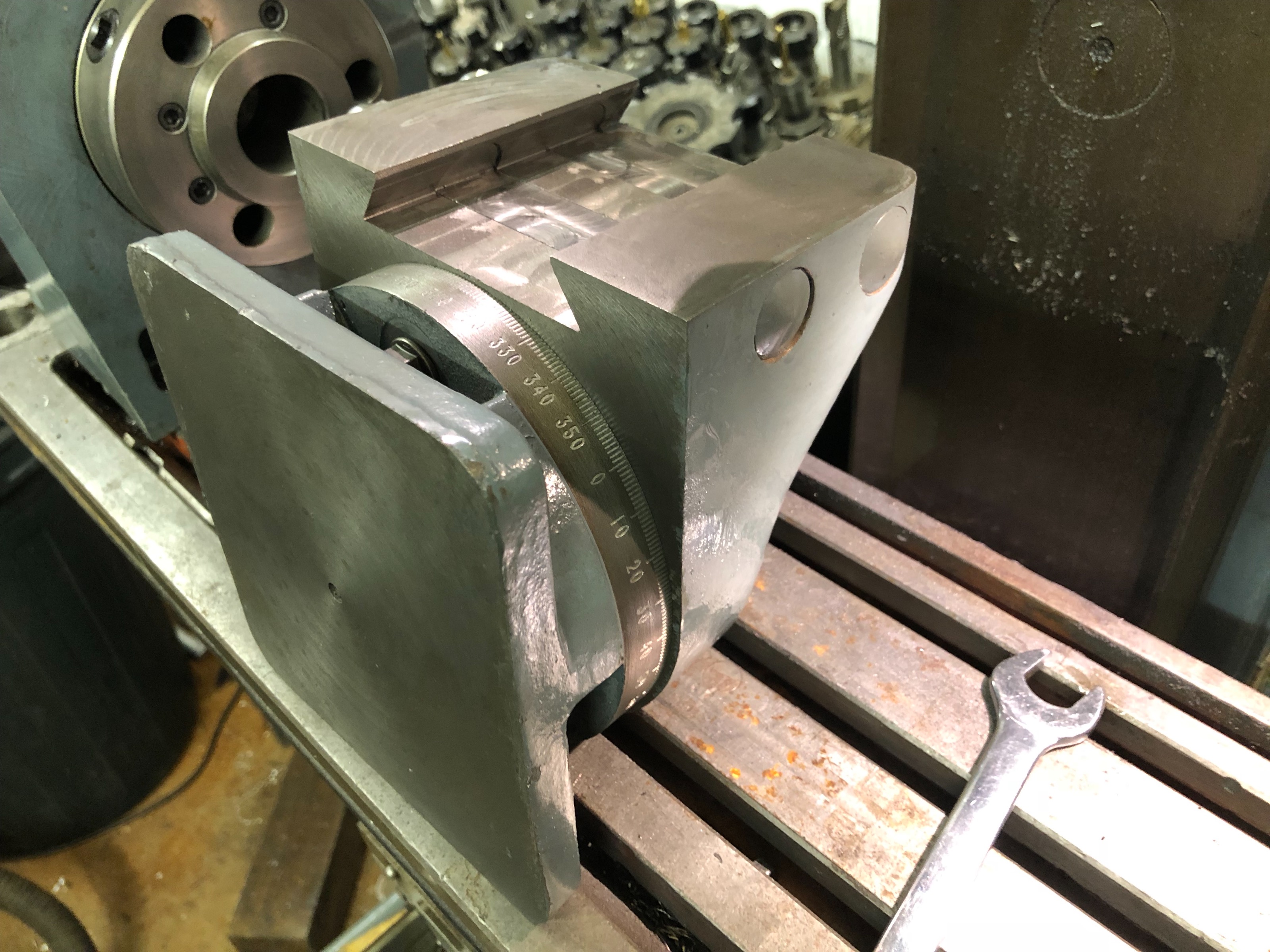

I actively avoid making money from this. It's important to me to keep it a hobby.. Please tell me you make money doing this......

Hi. This is almost what I was looking for
. I need to make a cylindrical dial for a leadscrew with 1/8 inch move per rotation. So it would be 125 ticks, each 5th is slightly bigger, each 10th is bit more bigger. And numbers 0, 10, 20,...110, 120 beside 10th ticks. How I can modify your code?
BTW, other dials, 1/10" per rotation or even metric would very useful.
- Posts: 19914
- Thank you received: 4663
06 Feb 2026 16:03 #342575
Replied by andypugh on topic G-code to engrave numbers on cylinders
Try just changing #<_inc> to 28.8 degrees (and see what the preview looks like)
That's 360 / 12.5 though it sounds a bit too large without testing, and I don't know what it will do at 120.
