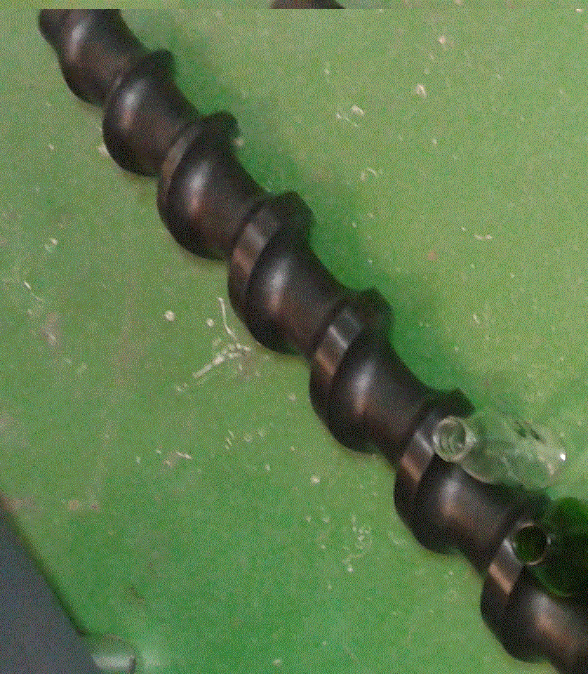

HI,
I NEED TO PERFORM A INCREMENTAL THREAD. NOW I'M PLANNING TO RETROFIT A CNC MILL (HEIDENHAIN TNC155) TO LINUXCNC. WILL BE POSSIBLE TO DO THIS WORK?.
ALSO, I HAVE ANOTHER MACHINE WITH A HEIDENHAIN TNC360, SO IT CAN CONTROL A FOURTH ROTATIONAL AXIS, BUT DON'T KNOW A WAY TO PERFORM THIS TASK.
HAVE ANYBODY EXPERIENCE ABOUT THAT?
THANKS IN ADVANCE, MARIO (AND SORRY FOR THE "WEIRD QUESTIONS"
PD: NOTE THAT IN THE THREAD, THE NOTCH WIDTH IS ALWAYS THE SAME, BUT THE CREST WIDTH IS DECREMENTING.

ok thanks i didn't know about exact limit in attachements, there is a trim... not a complete picture. But in essence, this is a polycarbonathe cylinder with a thread "incremental pitch" milled on it. The aim is to feed bottles in a filling machine so that arrive at a variable speed, but regard to incremental spiral geometry, at the end of the thread, the bottle speed and position is syncronized with the whole filling machine.

I see!
It is a bit of a cross between an archimedes screw and a barley twist chair leg.
So long as you can accomodate it on your machine, I would imagine it could be cut quite well using a mill with a 4th axis, the main problem would probably be flexing of the material away from the cutter, it would need supporting throughout its length.
What you need however is the G Code to cut the 'thread'
Although you could code it by hand I suspect a CAD / CAM route would be easier.
03 Feb 2014 21:57 #43496
Basically it seems to be a thread with a varying pitch.
If I was making one I would probably create the G-code in Excel, as a set of angular positions and calculated axial positions.
However, it could also be done by calculations inside G-code.
Consider a G-code loop iterating over angles in steps of (say) 10 degrees and calculating the required Z position.
#1 = 0
O100 while [#1 LT 3600]
G1 A#1 X[#1 * 20 + #1 * #1 * 0.2]
O100 endwhilePlease Log in or Create an account to join the conversation.
