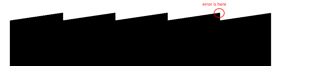

Hello. I have been running Linuxcnc lathe for a nice period of time and normally I can get things running as they are supposed to.
Currently I want to machine a very simple shape, but due to the compensation it is not letting me to.
The following code fails due to the compensation (the common gauge error), and I am not seeing correctly how to solve it.
Tool is outside machining, radius 0.4, tooltip direction 2 (linuxcnc tool tip direction)
Taking the compensation out, the code is accepted.
The output should be the outside of the picture attached.
I understand the problem, that is related with the intersection of the two lines that create a less than 90 degrees on the top, but at the same time is not clear to me to solve it (and still use the compensation ON that will be necessary).
Any ideas?
Thank you

(Init strings)
G21 (MM UNITS)
G18 (XZ PLANE)
G95 (UNITS PER REVOLUTION)
G7 (DIAMETER MODE)
( OUTSIDE MACHINING )
O9100 CALL
T1 M6
G43 (APPLY OFFSETS)
G96 D2500 S400 M4 M8
G00 X46.500 Z2
G00 Z4
F0.12
G00 G42 X45.043 Z2
G01 X43.798 Z-2.200
G01 X44.450 Z-2.200
G01 X43.798 Z-4.400
G01 X44.450 Z-4.400
G01 X43.798 Z-6.600
G01 X44.450 Z-6.600
G01 X43.798 Z-8.800
G01 X44.450 Z-8.800
G01 X43.650 Z-11.500
G01 Z-12.150
G00 X46.500
G00 G40 Z2The output should be the outside of the picture attached.
Any ideas?
Thank you

The error is more likely to be the inside corner not the outside corner. The error probably says near line xx and it is usually the next line. The inside corner can not be less than 90 with cutter comp as it can not reach the end of the vertical line before gouging into the next line. Try changing your code to put an arc or a short corner that can be reached by the tool.

Correct, I added a radius a little larger than the tool radius and the code is now accepted, and most important, it makes sense.
