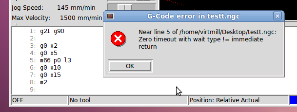

M66 problem - doesn't work without Q parameter

29 Jan 2015 21:59 #55444
by nebelnoir
M66 problem - doesn't work without Q parameter was created by nebelnoir

29 Jan 2015 22:23 #55445
Replied by PCW on topic M66 problem - doesn't work without Q parameter
why not just set Q3600 or so...

29 Jan 2015 22:43 #55446
by nebelnoir
Replied by nebelnoir on topic M66 problem - doesn't work without Q parameter
or
(user code)
M66 P0 L3 Q3600
M66 P0 L3 Q3600
M66 P0 L3 Q3600
(user code)
Ok. Вut what if this is a technical equipment in the production line, which can only work once a day?
Or (more generally) I need different branches of Gcode, depending on the input signals.
How can I use digital input as a parameter in O codes? (I've tried to use motion.digital-in-00 (pin) or din-00 (signal) as parameter but it doesn't work)

29 Jan 2015 22:50 #55448
If you need to branch then read immediate and then run conditional code
if you want to wait just use a long q value (Q31557600 will wait a year)

29 Jan 2015 22:56 - 29 Jan 2015 23:39 #55449
by nebelnoir
, ok it's work. SOLVED
g21 g90
g0 x0 y0 z0
g4 p3
g0 x100
M66 P1 L0 Q100
o100 if [#5399 EQ 0]
g0 X0
o100 endif
o110 if [#5399 EQ 1]
g0 z50
o110 endif
g0 y100
g4 p3
g0 x0 y0 z0
m2
Thank you!
(L- - Mode 0: IMMEDIATE - no waiting, returns immediately. The current value of the input is stored in parameter #5399
linuxcnc.org/docs/html/gcode/m-code.html#sec:M66-Input-Control )
