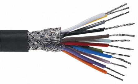

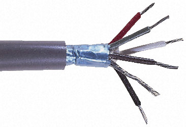

1) The screen ... Not sure if I am following you. Are you saying the screen goes over the electronics in the drawer and the screen gets grounded?
There are cables with either braided tinned copper wire or foil as the outer covering bar one.
If this outer screening is grounded it will protect the signal in the inner core(s)
If your components are grounded within a metal enclosure, that will also assist with screening.
Often all the components are mounted on an aluminium back plane or plate for that reason.

I have some shielded wire like you have shown me. It has 4 22AWG wires and a metal braid. I will use this wire from my drivers to the 4 pin MIC connectors on the back. I should ground the metal braid to the case in my controller box, correct? Not the 2 pairs that are in this wire are not twisted pairs, does that matter, or should I be looking for a different kind of wire? I plan on these connections to run from the controller to the MIC plugs away from the signal lines. On the output side of the MIC jacks, the motors are connected using (2) 22AWG Twisted pairs. Should I replace this with the shielded cable as well? My controllers are running at 3A, according to the AWG chart I should be good with 22AWG wire, but would there be any benefit to bumping it up to 20AWG or 18AWG?
