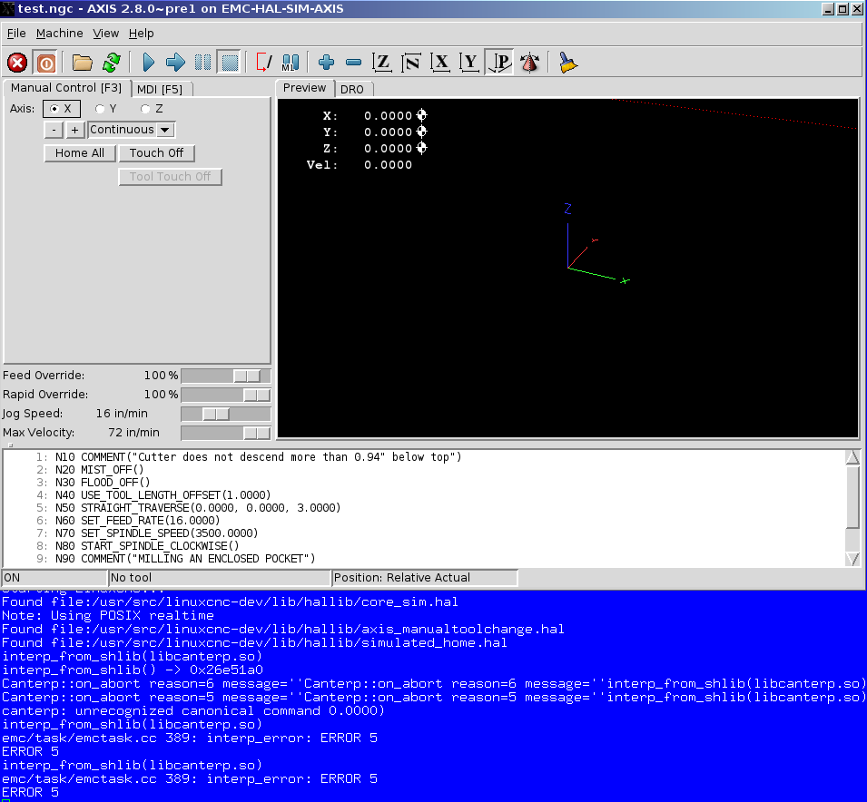

I am trying to find something simple STEP-NC code wise to test it, but don't have any time to do so for a while.
02 Nov 2015 17:23 #64618 by ArcEye
Replied by ArcEye on topic Use of STEP-NC with LinuxCNC

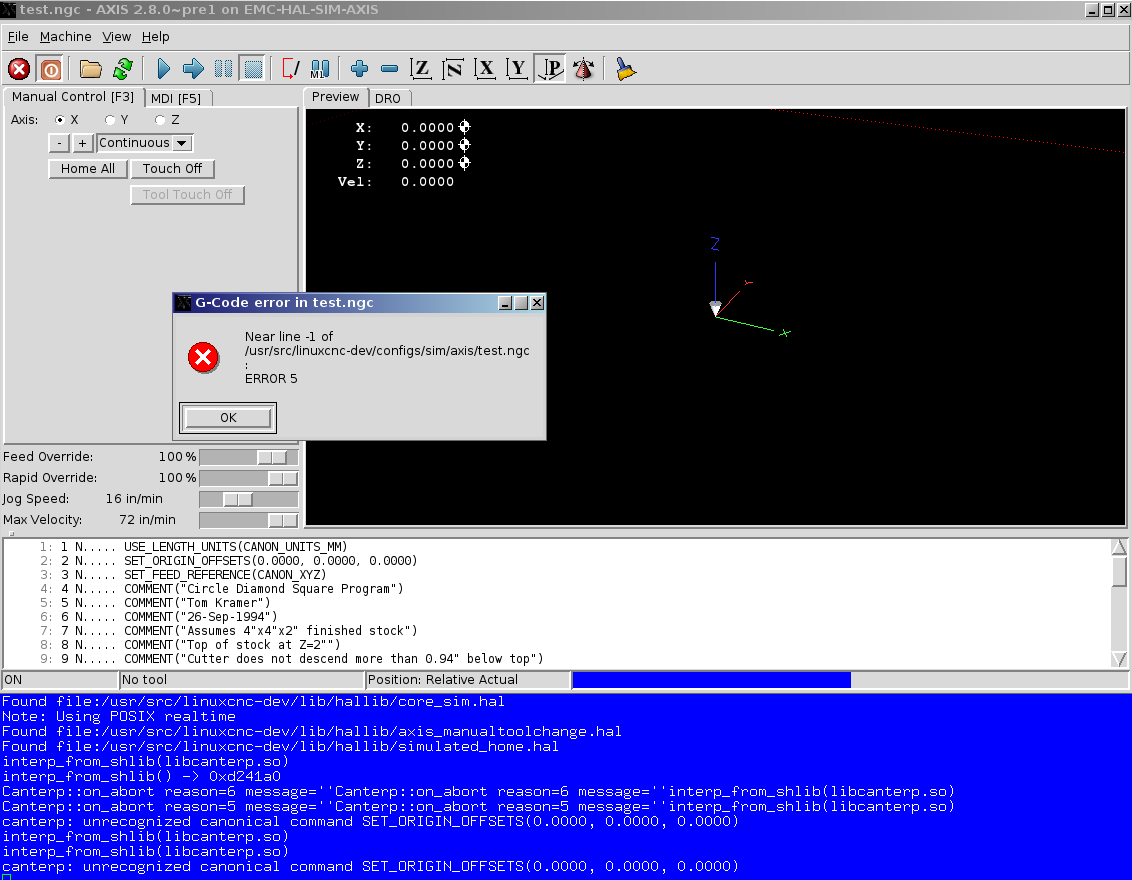

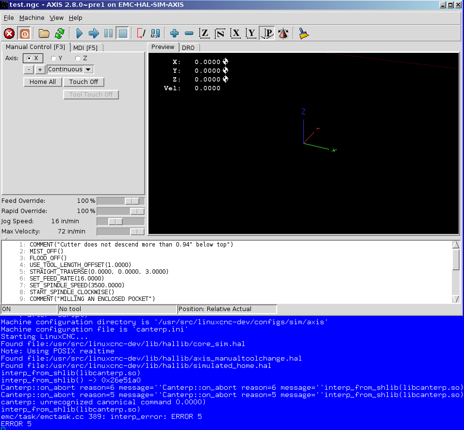

It turns out the interpreter has a sample file hard coded as default choice
The output is pretty identical to canterp.cc for example
  canterp.cc
  Straight-through interpreter of a file of printed canonical interface
  commands like these:

toolkit interpreter output from test file ex1.stp
1 USE_LENGTH_UNITS(CANON_UNITS_MM)
    2 SET_ORIGIN_OFFSETS(0.0000, 0.0000, 0.0000)

03 Nov 2015 11:42 #64672 by ArcEye
I had never noticed that either, receives no explanation in the README.
It loads but errors and you cannot load a file, errors on line 0 trying to read it.
Machine configuration directory is '/usr/src/linuxcnc-dev/configs/sim/axis'
Machine configuration file is 'canterp.ini'
Starting LinuxCNC...
Found file:/usr/src/linuxcnc-dev/lib/hallib/core_sim.hal
Note: Using POSIX realtime
Found file:/usr/src/linuxcnc-dev/lib/hallib/axis_manualtoolchange.hal
Found file:/usr/src/linuxcnc-dev/lib/hallib/simulated_home.hal
interp_from_shlib(libcanterp.so)
interp_from_shlib() -> 0x9dd1a0
Canterp::on_abort reason=6 message=''Canterp::on_abort reason=6 message=''interp_from_shlib(libcanterp.so)
Canterp::on_abort reason=5 message=''Canterp::on_abort reason=5 message=''interp_from_shlib(libcanterp.so)
The framework is there in the file tree src/emc/canterp/ complete with Submakefile
You just need to make it work first before trying to substitute for another interpreter
03 Nov 2015 11:52 #64674 by ArcEye
Also tried loading the file fragment from the header of the canterp.cc source
Shows it is reading it, even if it says it does not understand it.
03 Nov 2015 12:21 #64679 by andypugh
Replied by andypugh on topic Use of STEP-NC with LinuxCNC
Not the best of signs, that it fails to parse its own example...
Does it work if N.... is edited to be N0001 (ie, an actual number)
03 Nov 2015 13:13 #64691 by ArcEye
Already thought of that
No line numbers etc
Just line numbers
So first call is to get existing canterp.so working before even attempting to replace it.
Just a hint, I won't be trying :P
