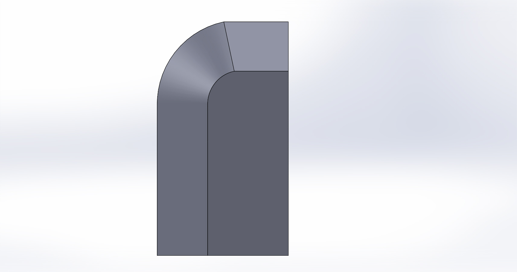

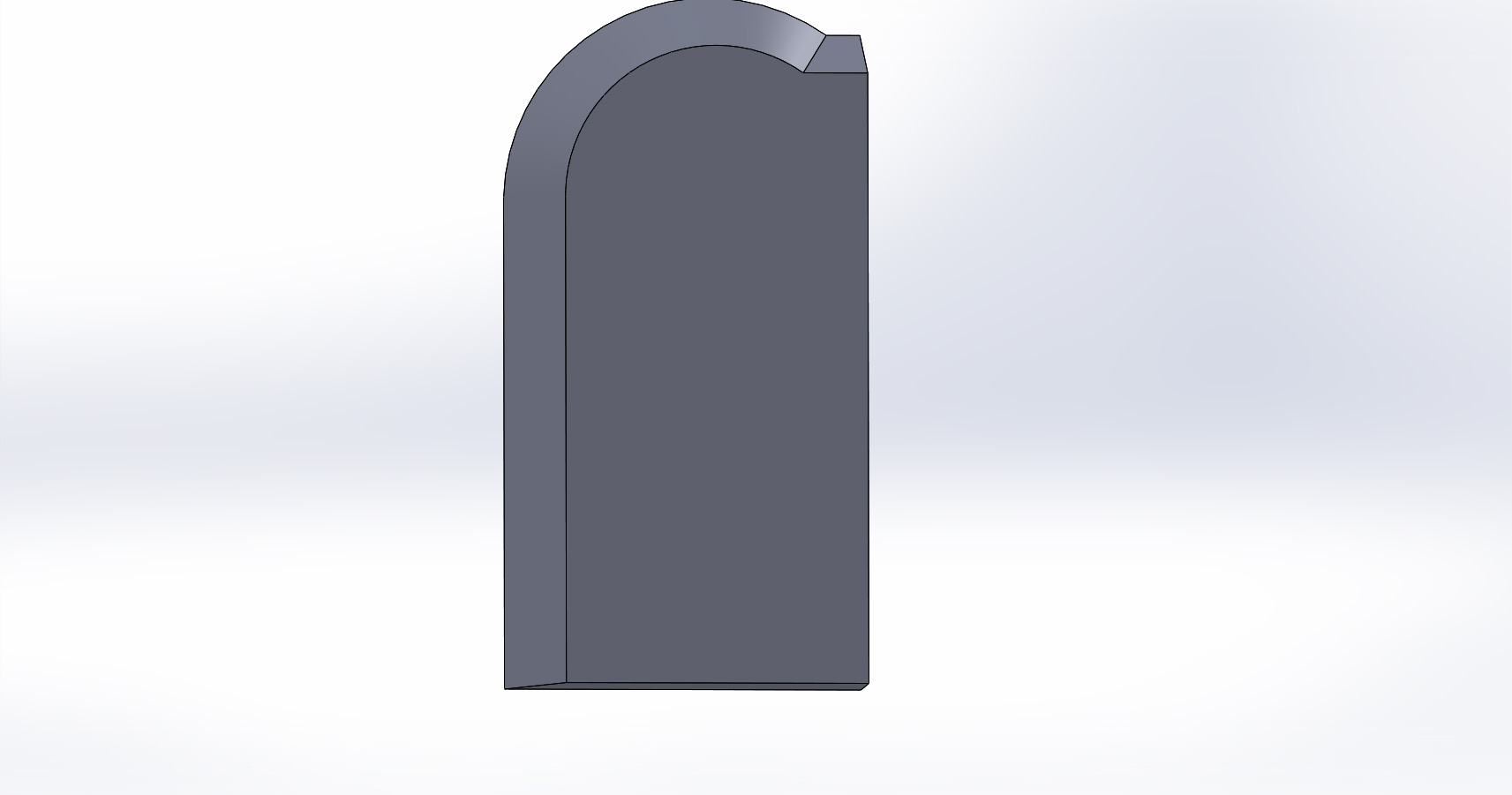

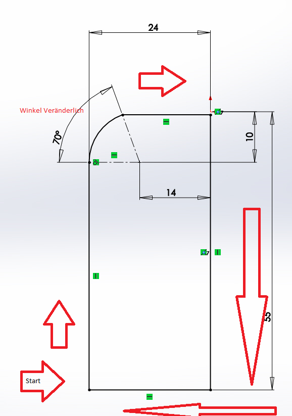

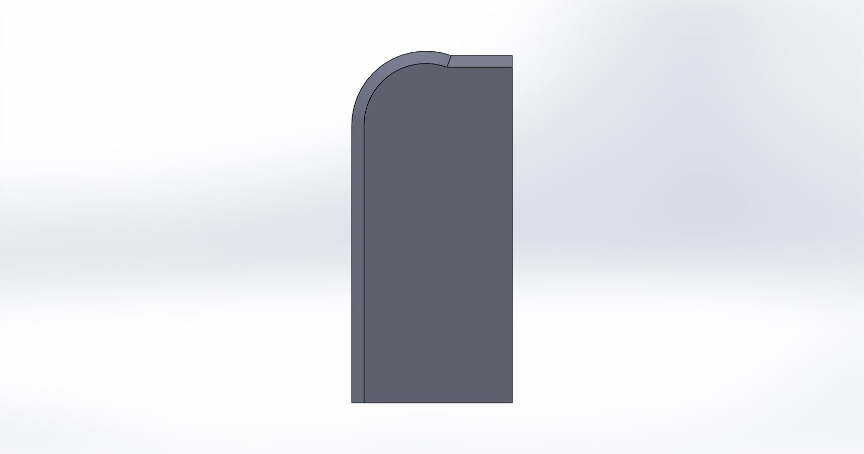

Dear Linuxcncusers.
I am using Linuxcnc since 5 years and never get a problem like this.
I Want to move an Radius incremental with an predfined angle. I set the I and J of the Radius with G90.1 to absolut. But this will not do what i want.
I have seen the documentation with polarcoodinates and think this must be helpfull buts not true.
The workpiece is evry pice not similar to the others and there are 100 of this. The angle of Radius and the angle of the side are not the same. On my machine at Work with Heidenhain control is no problem to do this on it.
A sample it looks like this codeThe Movement on X Axsis i havent implementet.
And as Sample now my Code wich i have done on Linuxcnc
For Better Understandig i Post the Complete Code and Drawing and as sample some Pieces of the Projekt.
Does anyone have a Idea ho to do this easy without CAM and without draw each point in CAD to messure the endponts of Radius.
Sorry for my English buts not my Native.
thank you and have a nice day
Roland

- Posts: 19904
19 Nov 2015 18:17 #65551
Replied by andypugh on topic Need help in Incremental Round Move
polar coordinates use the current (X,Y) zero as the centre point.
So, you either have to set a temporary zero position at your chosen centre, or use some trigonometry.
LinuxCNC G-code has Sin, Cos and Tan functions.
Polar coordinates does help, try this code:
G90.1 (Radius Center Absolute)
G0 X200 Y200
G92 X0 Y0 ; This is our new centre point
G0 X50
G90.1 ; absolute circle centres
G2 F2000 ^-112 I0 J0 ; 112 degree move around the new 0,0 point
G92.1 ;cancel the temporary offset
m2

23 Nov 2015 10:44 #65704
by jepler
Replied by jepler on topic Need help in Incremental Round Move
It sounds like you're describing a fillet operation. You're right that LinuxCNC's gcode dialect does not support this.
