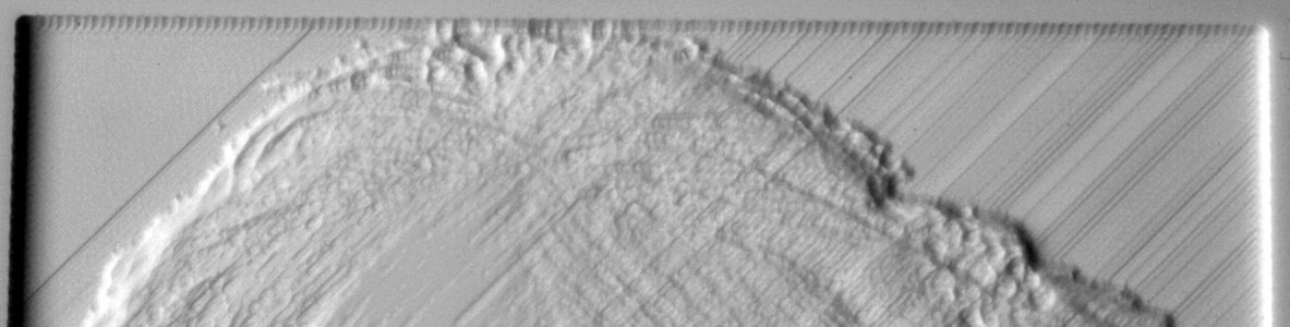

I've encountered a strange problem when machining something that has a lot of tiny Z axis moves - like lithopanes or fine 3d engravings.
I've made a few tests and here are the results:
When running this code:
Result is OK, my dial indicator shows 0.000mm
But when running this code:
Result is not OK, my dial indicator shows -0.620mm
Lowering Max Velocity and Max Acceleration does not help.
What is the cause of this problem and how to fix it?
Machine setup: EMC 2.3.5, stepper motors, gecko G212, HIWIN ballscrews, HIWIN linear rails,...
Attached picture shows errors on the right side, where is a lot of tiny Z axis moves, and perfectly flat plane on the left side.
Thanks,
David

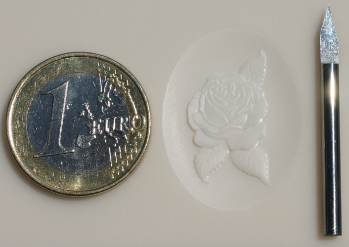

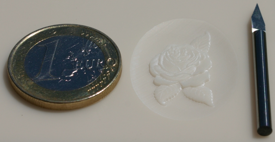

Problem solved.
Changing stepper controller from half step to 10 micro stepping did the trick.
I've machined the same lithopane again and now it came out OK.
But I'm still wandering if there is a software solution??
