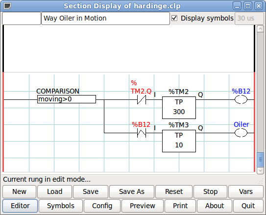

- BigJohnT
- Posts: 3981
- Thank you received: 994
23 May 2016 11:32 - 23 May 2016 11:32 #74976
by BigJohnT
Replied by BigJohnT on topic M7 & M8 G codes
I run my lube pump with classicladder. It's easy to set up a pulse timer circuit.
JT
JT
Last edit: 23 May 2016 11:32 by BigJohnT.
- lucky phil
- Posts: 24
31 May 2016 12:28 #75283
by lucky phil
Replied by lucky phil on topic M7 & M8 G codes
Hi JT
so with classic ladder am I able to put some buttons on my screen to turn on & off p/pin 14 & 16 while code is running and have a couple of buttons to adjust the on & off time on one of then(0.25-1.0 second on and 1.0-10.0 seconds off.
Any code snippets to help me would be appreciated as I am just learning linux.
Philip
Philip
- BigJohnT
- Posts: 3981
31 May 2016 23:16 #75300
by BigJohnT
What part of the puzzle are you missing?
I have a tutorial here:
gnipsel.com/linuxcnc/ladder/index.html
JT
loadrt mult2 count=3
# Way Oiler
addf mult2.2 servo-thread
# Way Oiler
setp mult2.2.in0 1000
net mult-vel mult2.2.in1 <= motion.current-vel
net in-motion classicladder.0.floatin-00 <= mult2.2.out
net oil-on hm2_5i20.0.gpio.045.out <= classicladder.0.out-07JT
