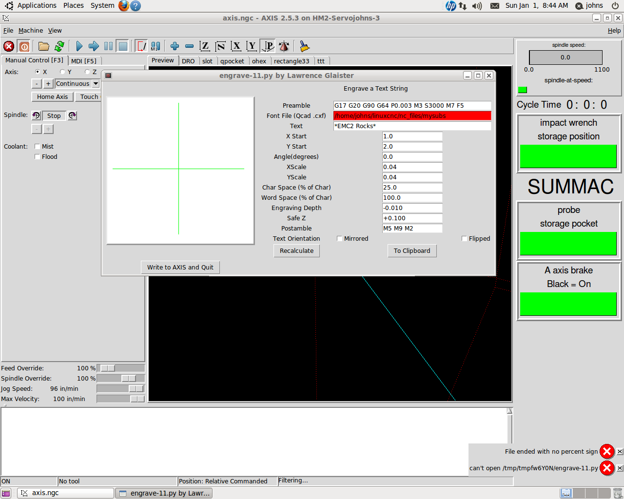

I am trying to engrave small text lettering 1/4" high with a 1/16" ball end mill. Is there a way to make it use one stroke , rather than moving around the perimeter of each part of the letter? (I want it like Haas default engraving)
I am using truetype tracer with ncgui on ubuntu 2.5.3
There are a bunch of different fonts that came with linuxcnc, but they all engrave the same way, by moving around the perimeter of each part and leaving an island in the center of each stroke.

cmorley, Thanks for the help. The wiki link that you posted is slightly different than the current one and has more information.
---Also, if you see the font path highlighted in RED, you probably do not have a correct path to a .cxf font file. ---

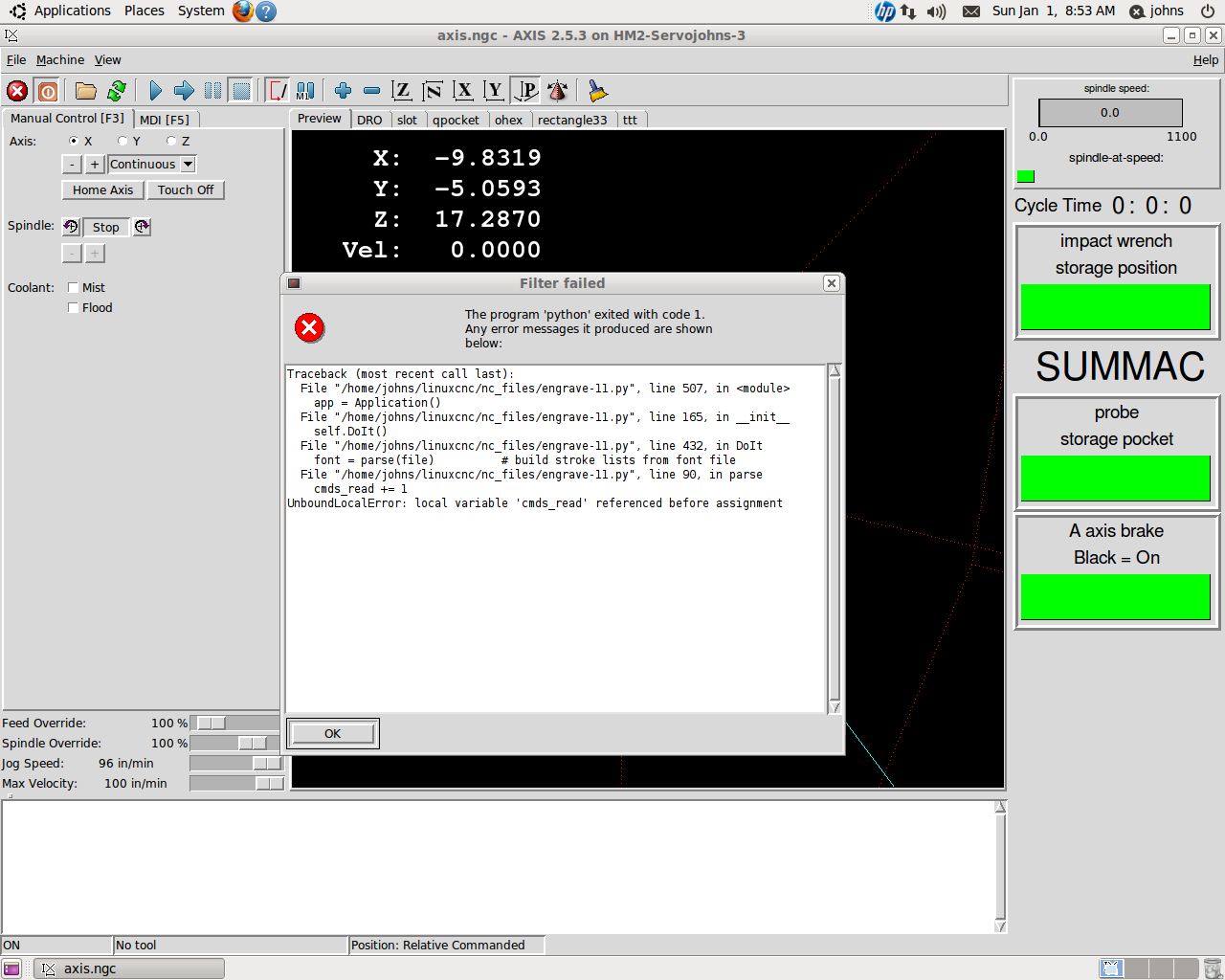

This is what my machine is doing. I put the engrave-11.py file and the font .cfx file in both nc_files and mysubs , without success.
I believe that I have the permissions on the files set correctly.(read and write, execute as program)
I have tried a bunch of different search paths, in the engrave-11.py file -

andypugh, thanks for the input. I need letters and numbers. Synaptic looks pretty complicated ,for me.
