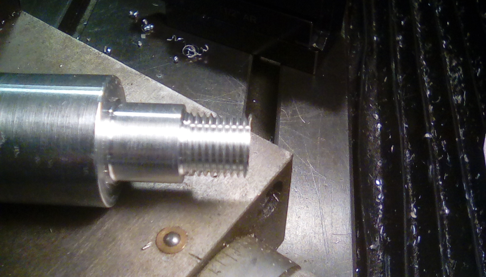

Been using the forum for a while now figured I'd give back.
I'm a mechanical engineer, with this forum i have been able to;
install linuxcnc
Double printer port and working with linuxcnc
Lathe threading with only single pulse by npn sensor (and get decent results)
Etc... (I'll share my hal later if anyone is interested)
Not a programmer or electrical engineer, so it is in excel. While lock/protected that's just to help keep selections to certain cells. But no password / blank password so if any daring programmer wants to python it.

23 Mar 2017 12:24 #90130
Replied by andypugh on topic G76 code creator based on ASME
If you want to attach an Excel file then you might need to Zip it.

23 Mar 2017 14:23 - 27 Mar 2017 15:39 #90144
by Sjdc1982
Replied by Sjdc1982 on topic G76 code creator based on ASME
Son of a gun, I didn't even notice lol.
drive link?
drive.google.com/file/d/0B475tbIYOx-cMjY...anM/view?usp=sharing
