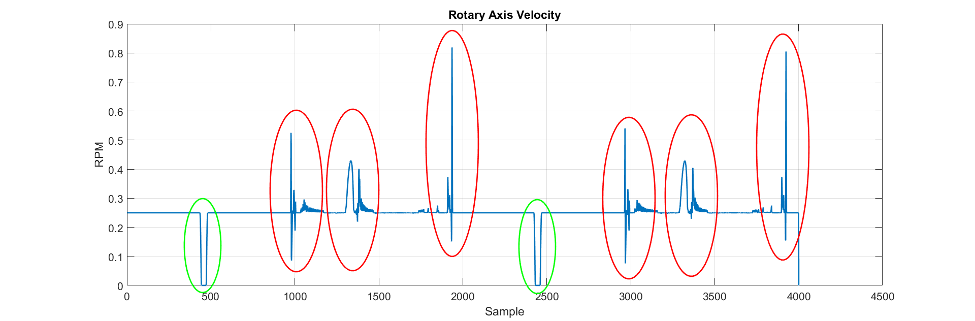

Hi Guys,
I recently reworked an old hydraulic grinding machine to be able to grind camshafts for the application within cars.
So I added some servo drives and a mesa-interface card... setting up the HAL and the motor tuning worked pretty fine (so well done... it's a very nice framework).
As the next step I designed a camshaft, which I would like to grind and tried to write some Gcode.
For the Gcode generation I have taken the designed camshaft, which is given in a kind of polar coordinates and interpolated each point with a linear movement.
Very important is that the rotary axis is rotating all the time with the same angular velocity to achieve a smooth surface of the camshaft.
So let's say the target angular velocity of the rotary axis is 0.25RPM.
As the next step I calculated the right velocity of the Z-Axis (the one which is driving the grinding wheel to the camshaft and away).
Therefore I simply used linear velocity and some Protagoras-theorem.
As soon as a tried to run this on the machine, the rotary velocity as everything else than constant.
In the above image you can see the setpoint velocity of the rotary axis based on my calculations, measured via the HAL-Scope.
The green deviations are ok for me, because I know why they exists (those are coming from the loop indices calculation).
But the red ones, should not exist.
I'm just wondering if my approach was wrong to the application.
Maybe you can give me any hints, how I can improve this to achieve a constant velocity on the rotary axis
Best Regards
Tobias

I think that this might be a job better handled by slaving the grinding wheel to the angular position, rather than trying to use coordinated motion. This would involve turning the work at a constant speed and using G33 moves.
Furthermore I think that there is a problem with coordinated moves in combined rotary-angular axes. Configuring the machine to use the Y-axis for the rotary position might help with that.
I have experimented with calculating the X position on-the-fly depending on spindle position. I don't think that I yet have all the answers.

Where is the encoder that reads velocity?
If its directly on the rotary axis, the tiniest motion from backlash, servo deadzone,
etc at 0.25 RPM will show huge velocity errors even though the position error may be quite small
that could explain the large (but short) velocity spikes
Also I note that the rotary axis does not appear to be under closed loop speed control
if you look at the worst (longest lasting) speed deviations, there is no matching velocity correction
so these may just be responses of the rotary axis to grinding load changes
Are the sample times in ms? if so the longest lasting velocity error is about 50 ms long and a about 0.2 RPM peak error
this amounts to an accumulated angular error of only about 0.03 degrees...

Hey PCW
I must admit, my figure from the initial post is not that clear as it could be.
The data you see there is the set-point velocity.
So no actual feedback signal is displayed.
The position error is way less than 100 mdeg.
And the set-point has been recorded without actual grinding anything, so there is no additional external force on the axis.
I tried re-configuring the machine, so that there is a spindle axis in the system and make use of synchronized motion.
But I was not really successful with this. The spindle was somehow not able to hold position and drifted a little bit.
This is not a really good behavior.
Regards
Tobias
Regards
Tobias
