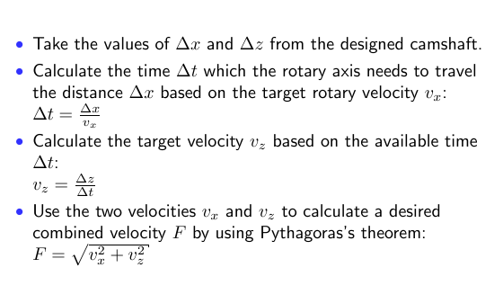

Ok, so I will stay with the "double linear" configuration.
I tried several acceleration values for the linear axis.
There I have not seen any improvement nor deterioration.
I have looked through the documentation, but I have not found any detailed information how the acceleration values are taken into account during a synchronized G01 movement.
Anyway I have just wrote down how I calculated the desired velocity of the system:
Maybe someone can point out where the flaw is in the calculation process?

I don't think that there is anything wrong with the calculation, but I am unsure why you are doing it.
The INI file limits should match the machine capability, not be based on the desired speed. They are limits.
