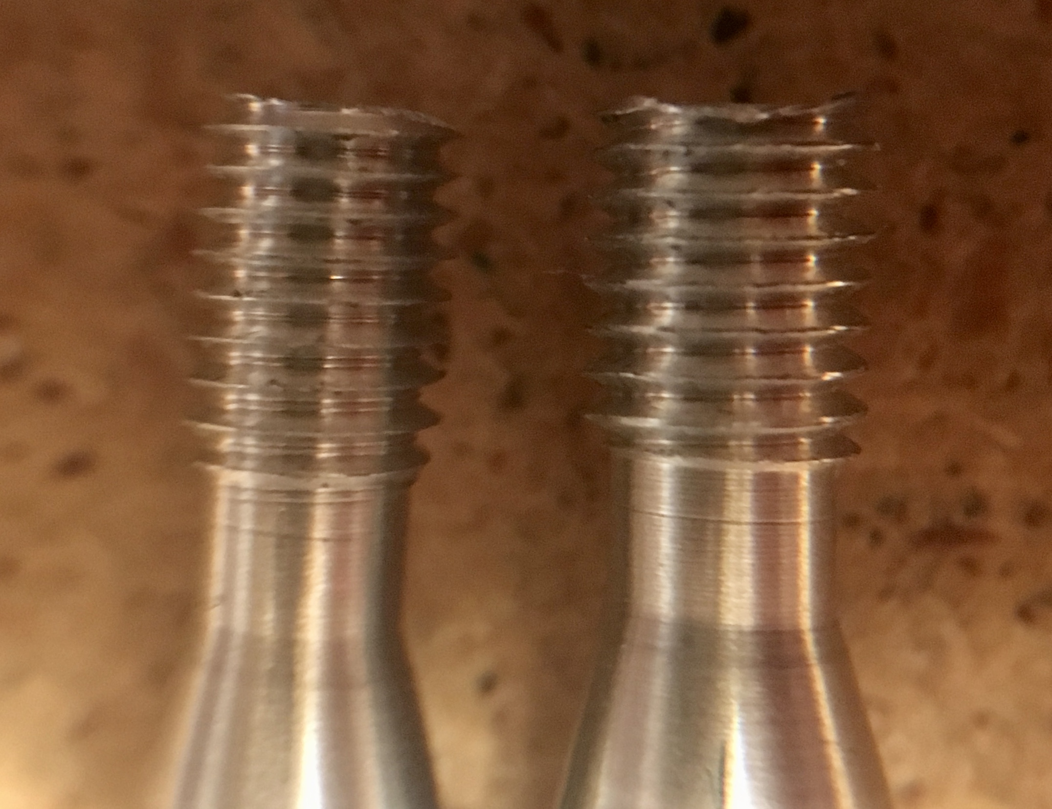

I am not sure what you are describing is the same issue I have. See the attached photo, this is what happens for me.
The left thread is G76, you see at the root of the thread that consecutive cuts do not sync the same so there are multiple "roots". The right thread is another algorithm where the sync stays good and the root is cut in the same place every cut.

Yeah, it's a similar issue with multiple roots that run parallel to each other. I don't believe it's a backlash issue either.

Oh, it does look the same for you.
I have some backlash in that lathe but both threads in the picture are cut in the same lathe and with the same setup.
I did not change the G76 algorithm. I have a separate code for moving and syncing the tool in my Xbox pendant implementation.
This code uses the same spindle encoder signal, but jog counts to sync the tool to the spindle absolute position.

That really shouldn't be better. In fact it ought to be far worse as the position commands are passing through non-realtime layers and USB!
Does your lathe have a spindle-at-speed signal? Are you threading in CSS mode?
Is this a servo or stepper machine?
Replied by andypugh on topic Unable to cut correct thread with G76

I am not using the very slow halui. I am using the 1000 Hz servo thread, which apparently is fast enough to make fine threads. An RT thread would maybe be a further advantage, but I did not need it. The proof is in the pudding.
The USB is not involved in the actual syncing, so that is not an issue.
I have no spindle at speed and I did not use CSS.
It is a stepper so it is possible that I am losing steps, but why would I only lose steps when using G76.
Edit: Also, the thread appearance is not consistent with what I would expect if it was a losing steps issue.
