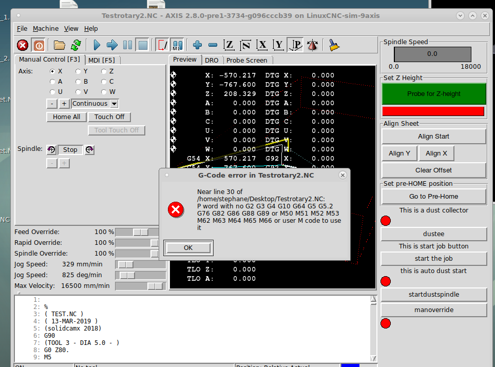

Hi everyone,
I have encountered a problem that is new to me. I think i need to install some subroutine to make it work, but i have no clue what to do.
The following line of code appears in my gcode to do a drill peck cycle.:
G98 G83 Z76.421 R104.923 Q5. P0 F100
LinuxCNC gives me an error on the P0 . What could i do about this? I am at a loss but i really want this drill cycle to work. ( SolidCAM postprocessor for 4 axis machine with Rotary Attachment )
The P is actually a pause of a number of seconds. 0 = 0sec P2 would be a 2 second pause between the cycles. So what to do?

16 Mar 2019 08:07 #128731
by Marcodi
Replied by Marcodi on topic Problem with following line of code. P0 in a peck drill cycle. How to solve
hi.
I just tried to change to 0.2 but that didnt do anything.
in attachment the error code it gives. and here some extra lines of code:

My guess is that linuxcnc can not handle a P word in G83 as this is a typical fanuc behaviour.

16 Mar 2019 09:06 #128738
by pl7i92
Replied by pl7i92 on topic Problem with following line of code. P0 in a peck drill cycle. How to solve
if you look carefuller inside the Gcode reference
www.linuxcnc.org/docs/html/gcode.html
there is the Dwell and the Peck cycle but no PECK dwell cycle
so you may edit your postprocessot on Drill do not output the P
