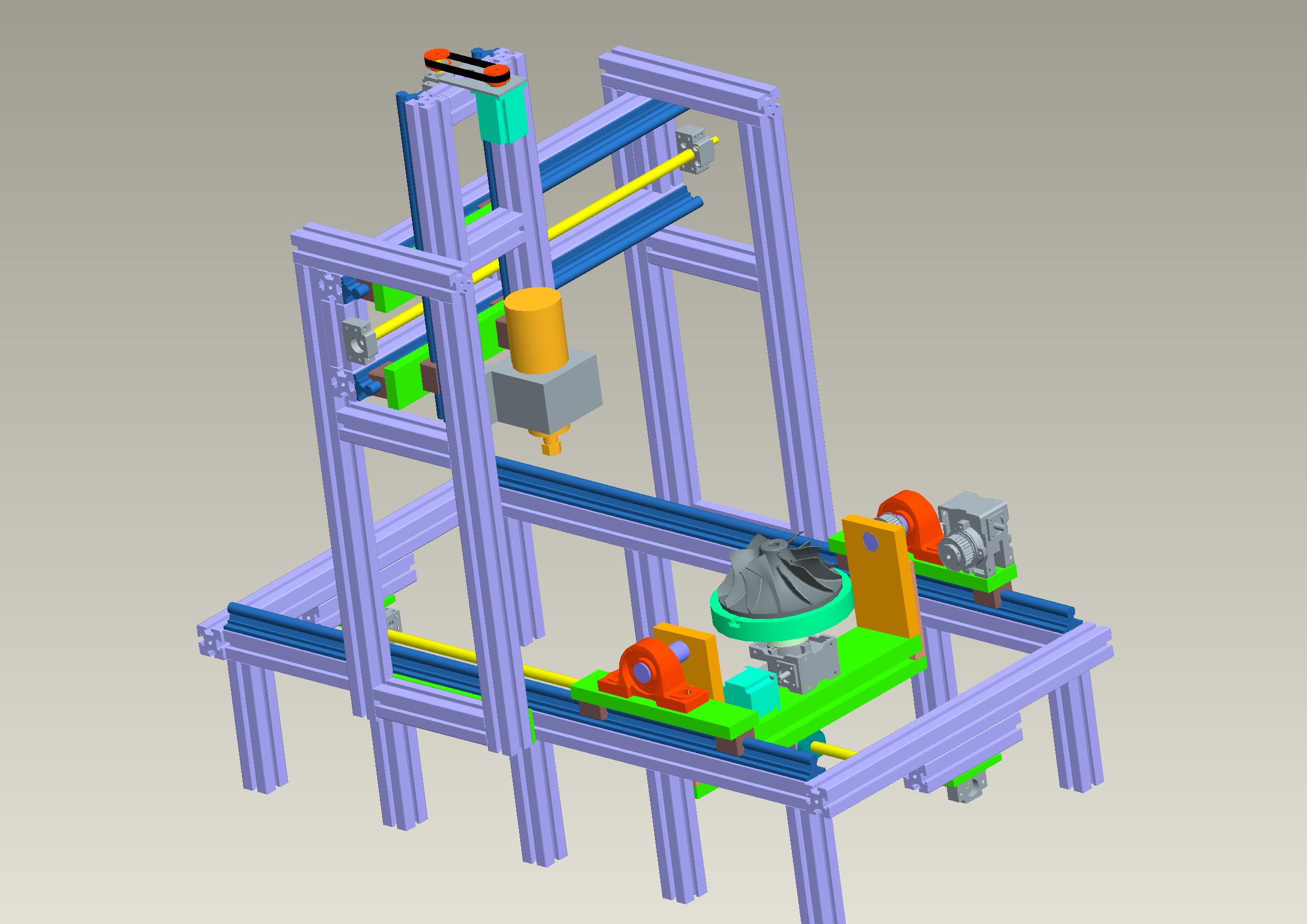

Okey, if you go to try EO stop right now. There is a version for you that can move like backward's. If you don't have this version
with your robot you miss a pointer. The combi version is Reverse Adaptive Feed + integrated Externall Offsets. And there is one place on the planet to get it.
If you have some drawings and dimension's of point's and joint's we can look at the interpolation model quite nice !

This is i think the only version available :
github.com/grotius-cnc/stable
It has reverse_feed and external_offset's in one version.
