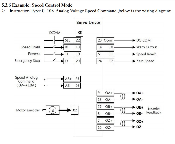

The lathe has a spindle servo motor with encoder. 1:1 ratio.
The encoder output from the driver is connected to the mesa 7i76e board. What do I need to change?

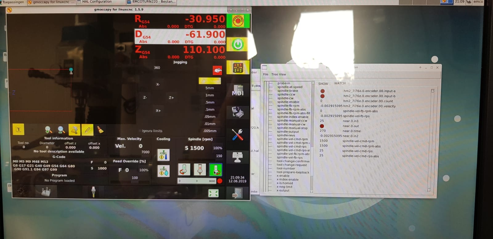

- Erikcnc
- Posts: 153
12 Jun 2019 14:15 - 12 Jun 2019 14:21 #136780
by Erikcnc
okay. so at 1500 rpm near.0.in1 gives a value of 25.
that should be fine. (1500/60)
but spindlevel-fb-rps gives a mutch lower value. and not constantly. it pops up ones a while. just enough to make a picture.
encoder scale is: 1024
Replied by Erikcnc on topic Lathe stops at code line
I suggest opening three halmeters and looking at near.0.in0, near.0.in1 and near.0.out
I suspect you might find that your spindle-velocity-fb has a different sign to the spindle-velocity-cmd. If it is that make your encoder scale negative. That's [SPINDLE_9]ENCODER_SCALE in your INI.
Last edit: 12 Jun 2019 14:21 by Erikcnc.
- Posts: 19908
- Thank you received: 4656
12 Jun 2019 14:21 #136782
Replied by andypugh on topic Lathe stops at code line
Looks like a problem with the spindle encoder.
hm2_7i76E.encoder.00.count is solidly on zero. This leads me to suspect that one of the spindle encoder phases is not connected.
(If this is deliberate then you need to set counter-mode to true for that encoder)
