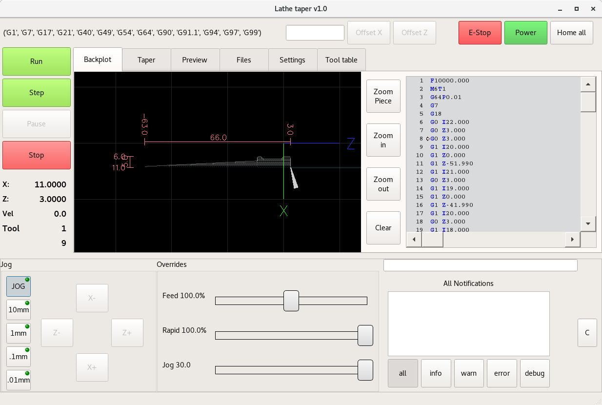

I can't understand why programmed ZX plane changes to XY when the program starts.
I have started Linuxcnc with G18 and only X and Z axes are defined in the configuration.
Screenshot attached with program stepped to a few lines of code. You can see the G-codes from Linuxcnc status in the upper left.
I'm using Linuxcnc 2.8.0-pre1

It is a statetags issue. Queued moves will be correct, error is only seen on the displayed modal codes. Interpreter sees M30 at the end and sets an initial modal state.
This is why I like to use % instead of M30.
linuxcnc.org/docs/html/gcode/m-code.html#mcode:m2-m30

You probably need to add G18 to the startup codes in the [RS274NGC] section of your INI file
linuxcnc.org/docs/html/lathe/lathe-user.html
[RS274NGC]
# g-code modal codes (modes) that the interpreter is initialized with on startup
RS274NGC_STARTUP_CODE = G18 G20 G90linuxcnc.org/docs/html/lathe/lathe-user.html

@Todd: Yeah, I have already done this.
@fixer:
"Selected plane is set to XY plane (like G17)."
Ha! I didn't pay attention to this in the documentation. It is a little strange that the interpreter decides to revert to G17, instead of the startup value, though.
I checked this and it does not change to G17 when using %
@fixer:
