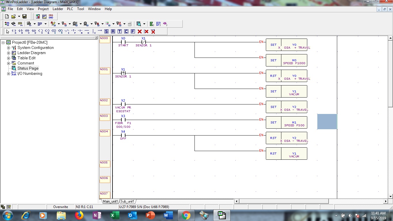

Greetings
Can anyone help i need M cod for external key:
1. Start button
2. The x axis is moving + position
3. When sensor 1 is active, the X axis stops and switches on output 1
4. when sensor 2 is active X axis returns
5. when sensor 3 active stopped the X axis and shut off output 1
Any help was welcome
greeting

I dont know how to do it with mcodes, but I would use classic ladder and pause and resume inputs if it were me.

That would be best.
I work with omron, fatek plc is not a problem but how do I run the X axis forward back and adjust the speed using classicladder in linuxcnc (moving x + moving x-)
An example
thanks for your reply
That would be best.
An example

Most probably with a small routine in gcode with the coresponding digital inputs and outputs.

If you would tell us exactly what you want to do then we could help more. With your scenario above, Classicladder will work.
But, you cannot move an axis directly with the PLC.

I need this

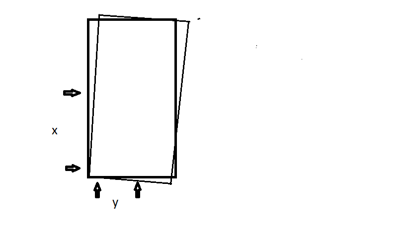

It's not over this is one part until I complete the whole line.
The next thing I need is an automatic correction of the x-z table against the z in case it is not straight because the length of the board is 6000mm. It would use an optical / laser sensor to find the edge of the glass.
Maybe someone has a solution or to help.
Hello
