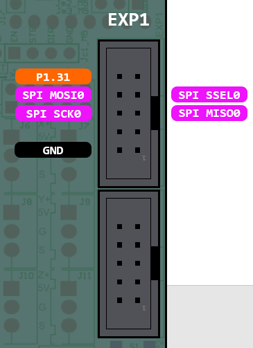

I am waiting for 2 MKS SGEN L v1.0 pcbs to try your Remora module with linuxCNC. They use the LPC1769 so may work with Remora. Could you tell me how you made the diagram for linuxcnc <--> remora? This is in the E-Stop loop section. It looked like XOD but only similar.. Graphic documentation of Hal nets is an on-going interest of mine.

Thanks for your interest in Remora. There are a few people discovering this project and have it up and running on printers and mills. I'm trying to keep up with features.
I like the graphical representation of HAL. An easy way of explaining how the "wiring" works. This is one of the great strengths of LinuxCNC but one of the hardest for people to get their head around.
Many applications are now using a node approach for work flows and I stole the colour scheme from DaVinci Resolve and drew it up in PowerPoint unfortunately. I'd love to see a graphical tool to create the HAL files. But beyond me I'm afraid.
